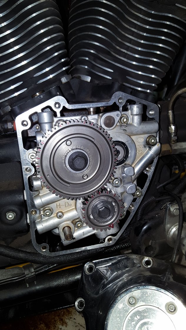

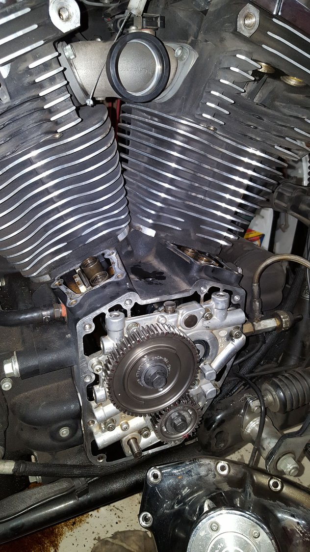

As has been said, check crank run out first; should be less than .003". If budget allows gear drive, that's the way to go; no more tensioner issues; nada forever. The S&S 509 is a better choice than the 510 because of the earlier intake close which increases corrected compression and CCP which makes torque. You don't need a high volume pump but if you want one there is one available from Daytona for about $140 on Ebay. Upgrade your inner cam bearings while you at it as well as the outer cam bearings. There are some "package" deals for cams, gears, bearings available online. You will need some tools for the job but there are work arounds that will save you some $$.
Remember that the valve springs in the '04 heads limit cam lift to .510" according to the MoCo but many have run up to .525" lift with no issues. Having said that, the S&S 509 is a great choice for a cam only upgrade for an otherwise stock or Stage I TC88.
Photos of how to check crank run out and set lash on inner and outer gears FYI.
