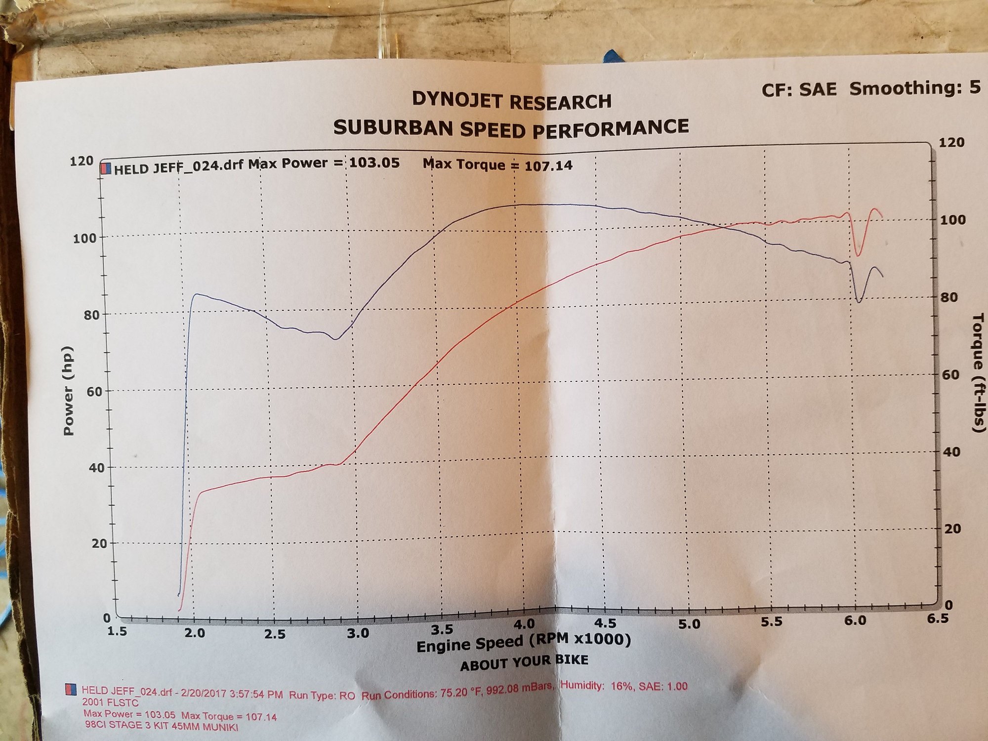

Best advice I can give is call Scott. He should be able to guide you through the proper conversation with your dyno guy.
Your air fuel seems to dip a tad right at same point.

My guess is it's the tune. I had a similar dip on my 103 at about the same spot as yours that I could feel when riding. Had it retuned and now no problem. It was running rich where the dip was. I'm running ported heads, 10.5 CR, and a Dragula 1 for what it's worth.

Mine has a similar dip, I believe it's due to being rich and the pipe I have.

What cam are you running.

S&S 585G, 10.5:1 C/R, ported heads, 45mm Mikuni, Rinehart 2 into 1.
