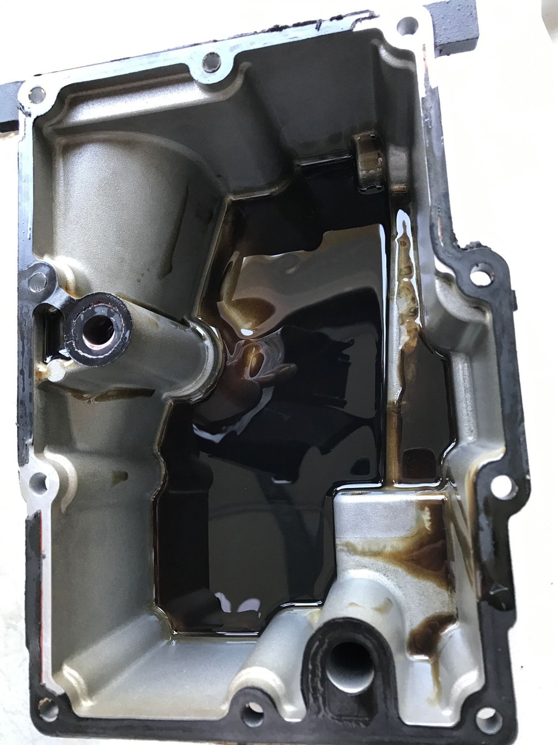

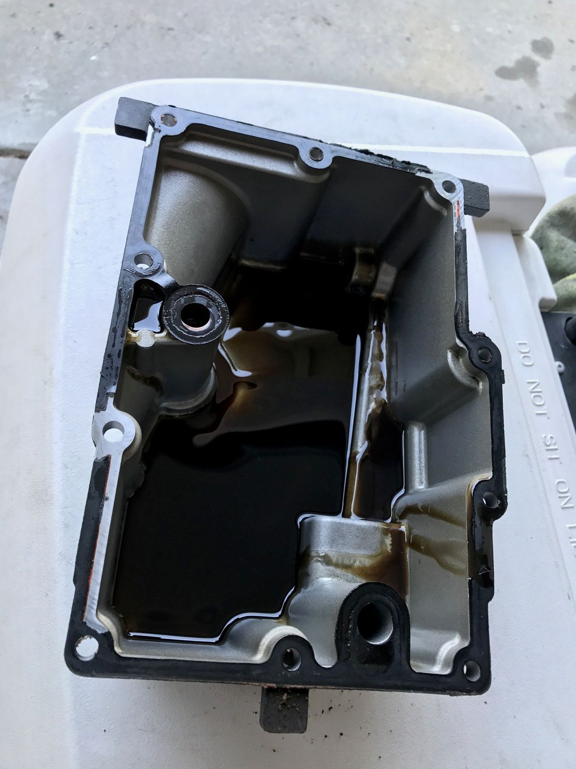

I was able to pull the oil pan over the weekend to check if I saw any debri or metal shavings inside and I didn't see anything out of the norm. Looks good to me! (baffle is to the side, I removed it to take a photo of the full pan)

Normally a top end would no require a rebuild with only 40K miles. What was wrong with the motor that forced the decision to rebuild? Was oil consumption excessive? Was a compression and/or a leak down test performed? Was the motor making terrible noises? In post #4, you refer to "their findings"; what were they? Aside from the lifter scoring, what other problems are there?
You might consider getting online and requesting an oil sample kit from Blackstone and sending in an oil sample for analysis.

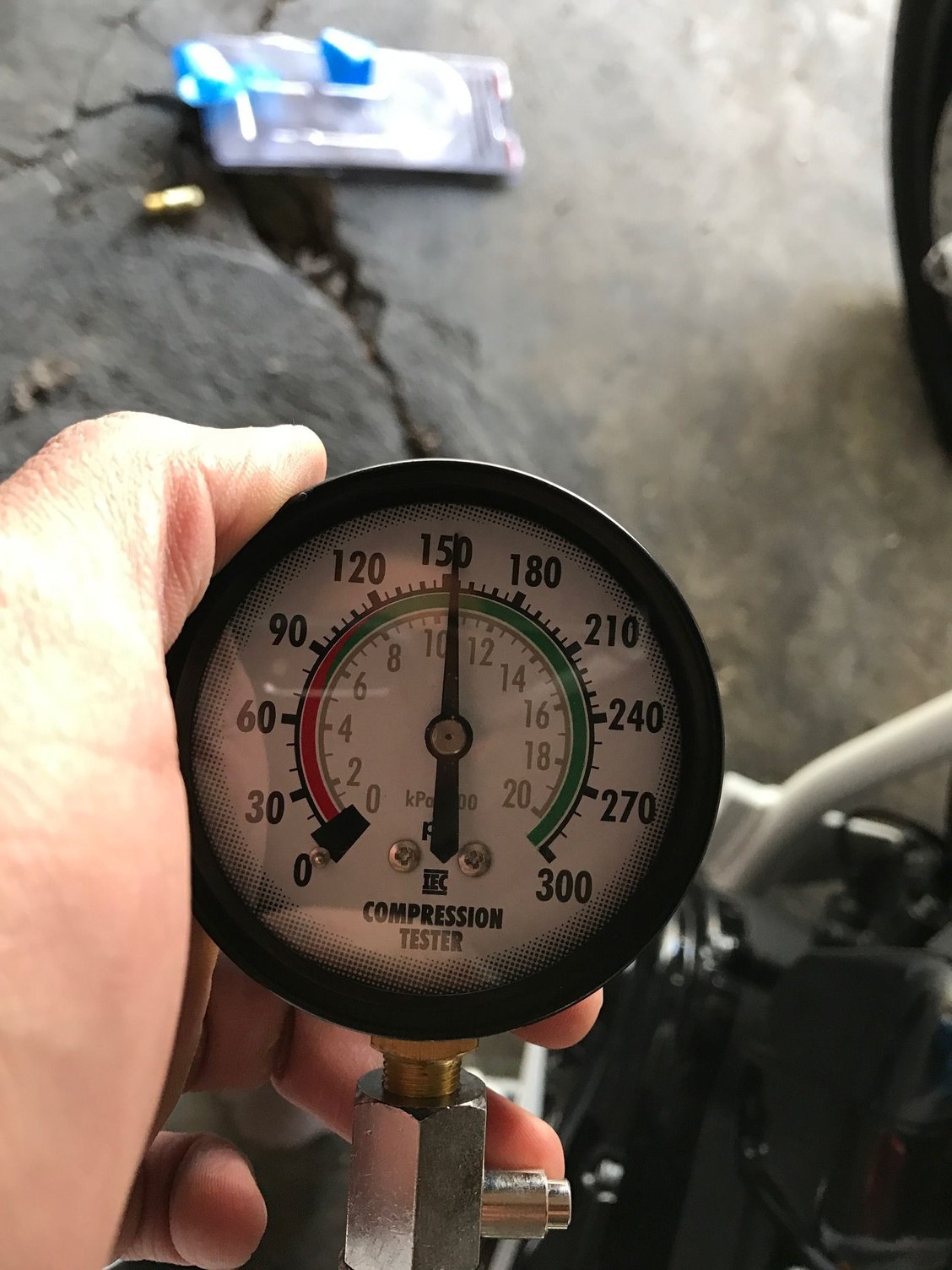

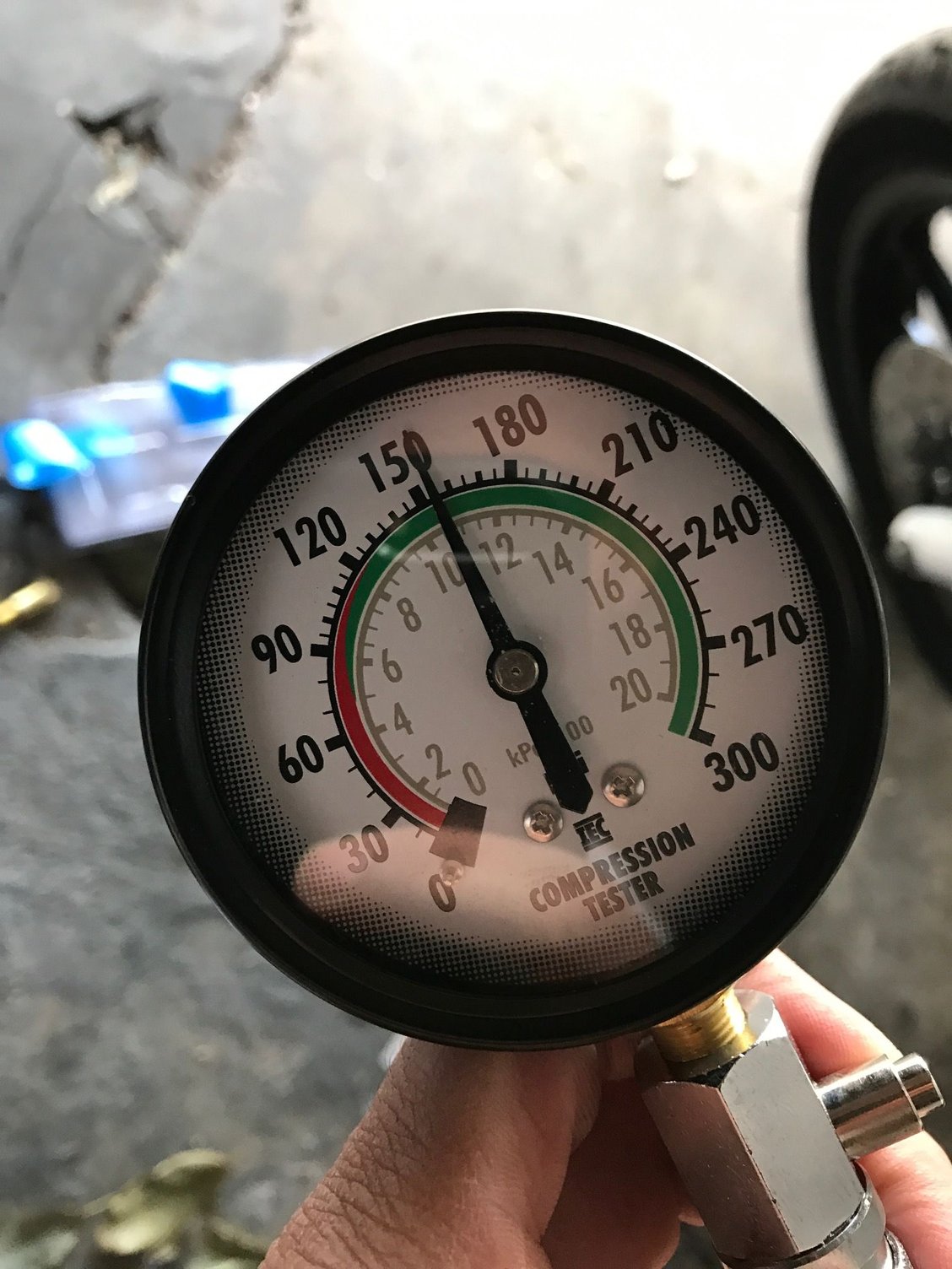

I wanted to do a "before the riding season upgrade" which was a bolt on 95" top end. I called a local shop and asked them to gap the rings and set them on the pistons inside barrels for me. When the went to remove the old pistons they saw the stock pistons and the minor scoring which they decided to look at the lifters and found them as mentioned.
I was then told it wasn't recommended i put the new top end on and suggested I find the source of the problem.
I did do a compression test before all of this and got normal numbers I'd say.

If running the OEM head gasket, compression looks good; my calculator shows it should be about 154psi at sea level. Piston looks fine except for the carbon build up; vent the heads to the atmosphere with your next build to mitigate against carbon buildup.
If you have the tools, check the lifter bore to lifter fitment; if fitment is within service limits, rebuild the top end and replace the lifters. Check crank run out for future reference; if it is way out, you should revert to the OEM chain drive setup. Unless you know the chamber volume of the heads, I would check that as well to know what you are dealing with. Chambers need to be 78-80cc to get the most out of those 510 cams and a .030" head gasket as well.
Unless you know the history of the 95" pistons/cylinders, it would be worthwhile to check fitment in torque plates. You may have all this data already but if not, it would be worthwhile to verify everything so you know what you are building. JMHO.
