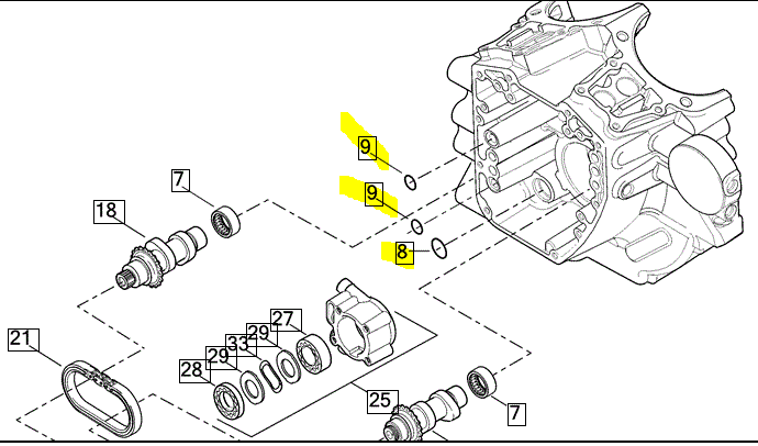

since i'll be in the cam chest checking the run out. are there some thing i need to watch/not do while in there? the oil pump and such... i have no idea what i'm doing. i have a service manual and will read through repeatedly. i asking about the things that aren't in the service manual that will make me have a baaadddd day.

Always replace the O ring that goes on the spigot from the pump to the case with a new viton O ring.. The smaller ones that go between the cam plate and case can be OK if still soft..
you mean 8 and 9 here?
Number 8 is the important one.. It attempts to seal radially by fit and not under compression like the 9s.
