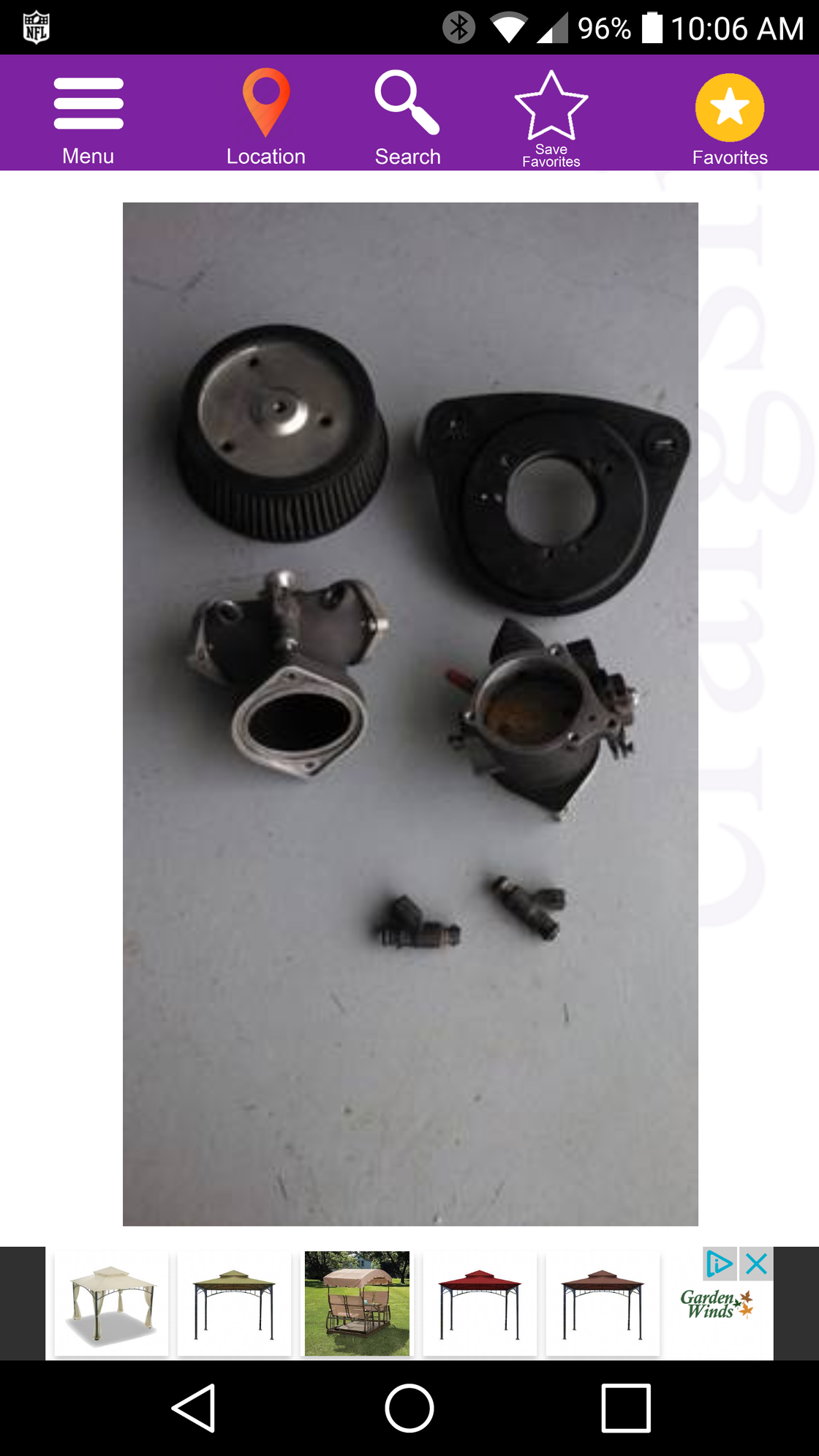

I was looking on Craigslist and I found a Jim's 62mm cable. Don't know if this will fit.
