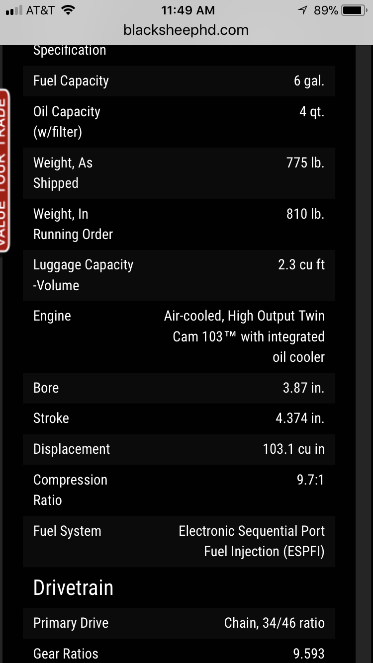

oh i thought air cooled was advertised at 9.7:1 an twin cooled at 10:1?

Not the HO103 motors; both at 10:1; the "regular" 103 is, as you point out, advertised at 9.7:1.

Not tryin to step on anyones toes but every thing ive ever read says regular 103 is 9.6:1 14’ and up ho 103 is 9.7:1 and twin cooled which is 14’ to 16 is advertised 10:1 this photo is from specs on a 2016 street glide 103 ho at 9.7:1 from a harley dealer . Thanks for the help im young an just learning .
