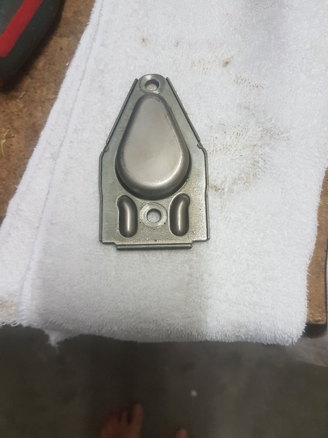

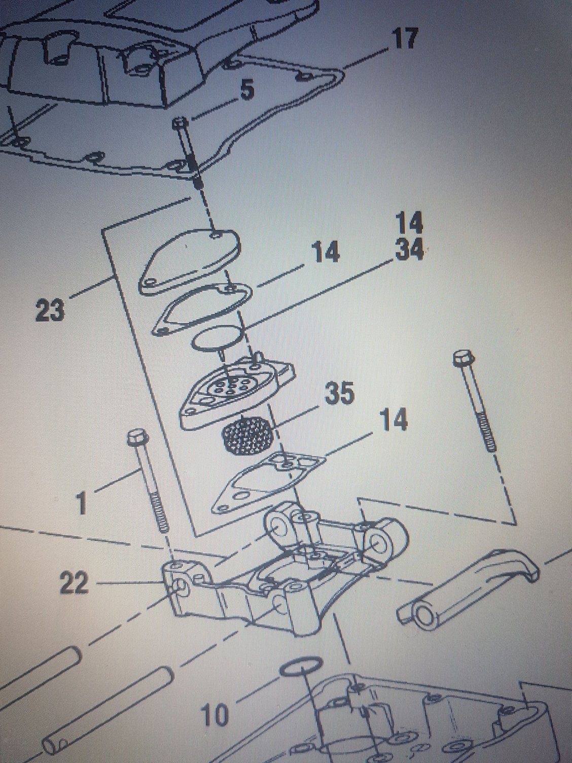

First pic is out of 09 service manual - the rest is what i actually have
Has mine been changed or upgraded ? checked ronniesonline and all 08-09 and 10 are the same as the parts book pics

Ronnies shows it as the 11 up breather but i still dont have that umbrella thing , why would this be done ?

So seeing that little umbrella valve is like a check valve not allowing the gases back into the exhaust . Is this just a cheap way to bypass the exhaust from returning it back to the intake ?

No, it's a check valve to not allow contaminants back into the crankcase. Remember these breathers are for releasing crankcase pressure. Helps to keep your gaskets and seals from leaking.

can you run without it??? sure, was done for decades on engines.
is it important??? well
it prevents atmospheric air back into the c/c which will reduce condensation and cleaner oil
it helps create a vacuum in the c/c which helps increase power
it helps in oil control on the piston assy
it helps oil flow as hd engines uses this diff'l pressure to move the oil from the flywheel area
awhile back, i think hd got rid of the packing since it had a tendency to clog. most of the oil is removed by the labyrinth chamber.
