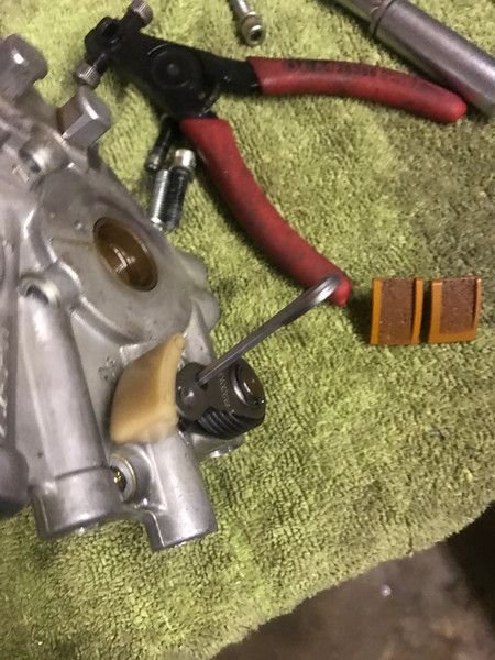

Like the title says, sometimes a cheap fix is just as good 2002 Dyna that I have NEVER been kind to.

That's great to see some proof they actually work. Just put cyco shoes on my FLH, only have about 3k on them so far. Cycos will be going in the fatboy next tensioner change. They seem like a quality product.

They turn that color from white as they get older, when that happens I dunno. That said, I've never seen an old one crater on the face or get brittle like the OEM. I changed a pair of Cycos for a guy at 15K miles (I didn't know how far they would go). I hit them with a hammer pretty good and they didn't shatter like OEMs do (on the bench, just the shoes).

Thanks for that post, I just put them in at 20,000 and my old shoes had some life but nothing like your Cyco
Some say crank runout has a lot to do with wear. When I checked mine it was 0.0015, so I should be in good shap

The burrs on the Morse Chain links,(and not all were like that) are the root issue of shoe wear.
As the burrs were "polished" from friction, the chain becomes smooth.
Seen shoes harmed in 1200 miles, had one in with 131,000 that had the original shoes, but were in dire need.

I'm far from an engineer but I think the inner spring tensioner shoes show more wear than the outer is because of the way the shoe sits on the chain and that the chain runs from top to bottom and causes it to dig into the shoe; literally, they contact each other at the end of the fulcrum.
I do agree that some of the Morse chains are rougher than others. I've done a few and you can sometimes feel a difference on the back of the chain.

It's interesting since the outboard one actually has the load of both cams on it. I know when people use Harley's so called SE up grade, they get shafted twice by the mothership since it leaves the link chain on the inside cam with a hydraulic tensioner. If by chance they modify the oilpressure relief, it puts a double whammy on that tensioner. Talk about a mothership screwing that is.
The roller chain only wears till it grooves in and then rolls. However these shoes harden in hot oil. So at a minimum, all shoes even roller chain ones should never be left in longer the 10 years. My original ones are way over due on my 04 at almost 50k
