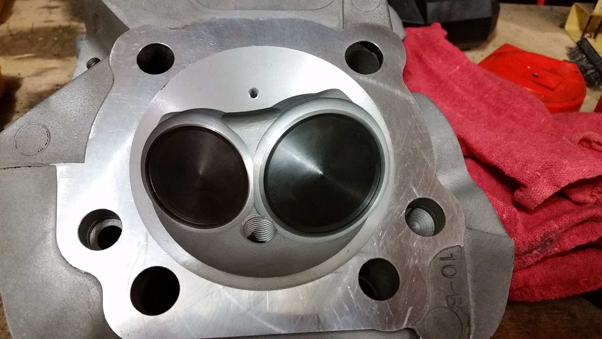

Here's what I ended up doing, in case anyone was on the edge of their seat about it

Are those the practice heads in the above pics?

Okay I just realized those are the heads that are going on the bike man those are some big *** valves. What's the combustion chamber sizes of those heads?

Yea, I practiced on one head, which went really well so I didn't practice on the other. 91cc I believe. FYI, I put the head build sheet in my other topic in the Evo forum.
