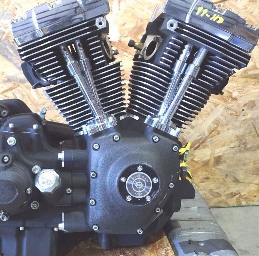

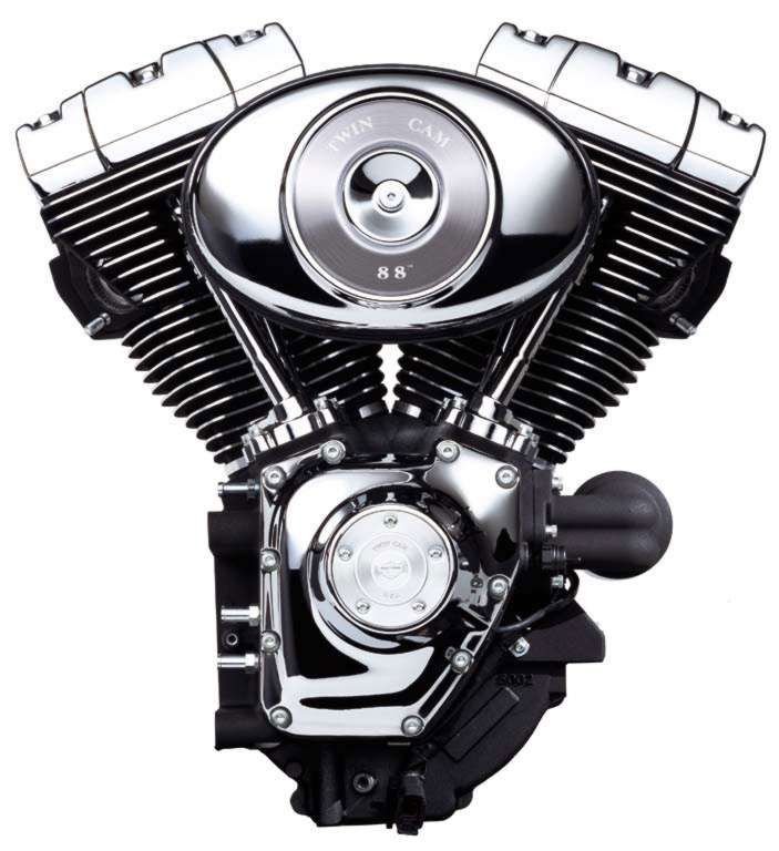

I'll be damned, I retract my previous statement. I made an assumption they all had the same bolting patterns and oil pump hookups onto the transmission.
88"
96"
