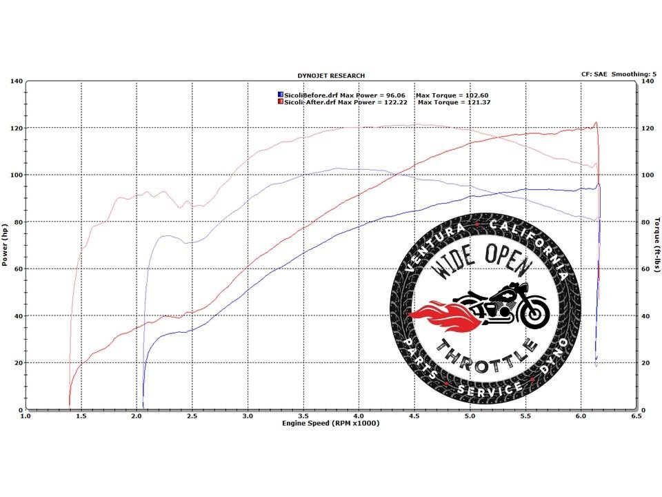

Looks like a great setup. I've attached a dyno sheet from a 110 using S&S HP103 cams which are similar to your grind (I Think). How does this compare to your curve?

your curve looks much better comes on earlier . I am getting my retuned with tts mastertune. Here is my dyno

Advance the cams +4* and it will come on sooner. About 300 to 400 R's.. The crank sprocket will have a tighter fit also. The stock one on mine was sloppy.

Oh I see, the wood 8 was in the full 110 build already. Misread the post. Maybe I’ve seen the tw8 with a tad bit more compression and a little better low rpm. What exhaust are you using?

Looks like maybe a really bad exhaust system. Probably not a cam issue at all.
Everything must work together!!
