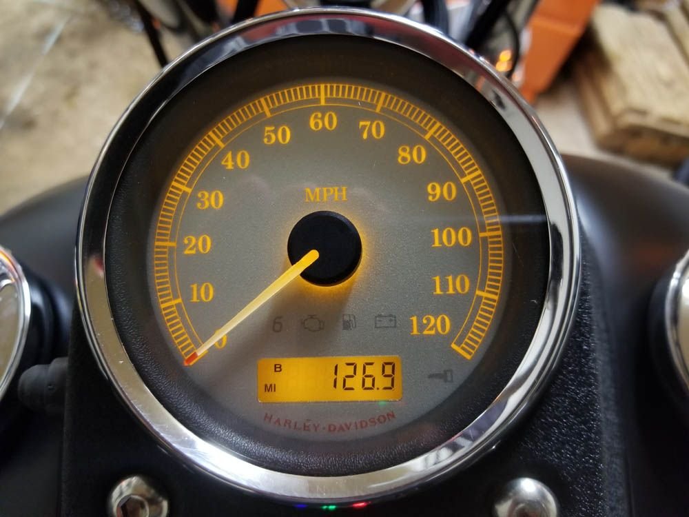

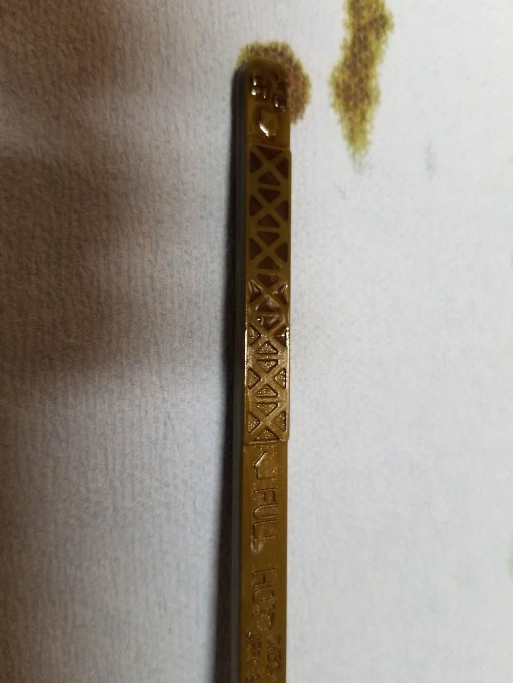

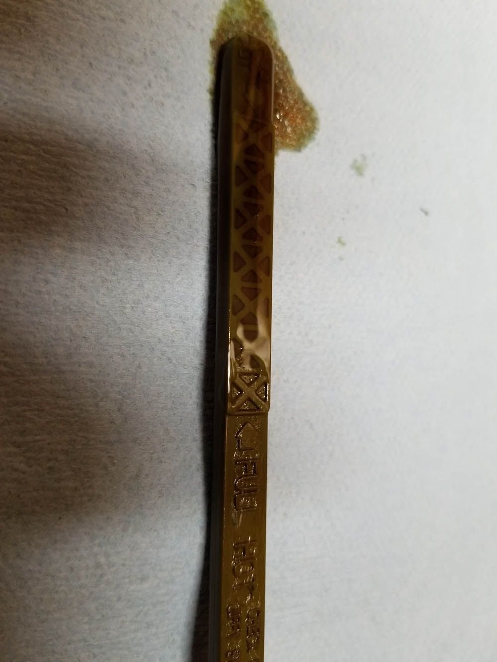

So, I topped it off this morning and took a picture of the dipstick while cold to measure it against a level after some highway miles to see if normal highway riding would consume as much oil as romping on it around town. I hate to post exactly what I've found, but I would say if the dipstick is split up into 7 sections of X's from the 'Add Oil' line to the 'Full When Hot' line - I'm really poor at math, but say 1,000 miles divided by 7 is 142. So, if you rode 142 miles and you consumed one section of X your oil consumption would roughly be 1 quart per 1,000 miles?
The results of my test ride seem to indicate it almost eating two X's in what was a few more miles than indicated on the trip meter (I forgot to reset until after I left out), but safe to say just under the 142 miles marker which could equate to almost 2 quarts per 1k miles?
What could this be? Wouldn't the engine feel less powerful if the rings were worn - like lost compression or something? I feels stronger if anything. It's just drinking oil now compared to what it used to consume. It doesn't drip one drop of oil on the ground in the garage.

Before you start freaking out about your engine you need to conduct your oil level measurements the exact same way every time. It's called a datum, and it means a common reference point for all information going forward.
First you say you took a cold measurement, then a hot measurement. Stop that! Do all measurements hot.
Also, put the bike in the exact same spot on the ground every time. Do you have a flat garage floor? Use it. Hell, even put little marks on the floor so your readings are consistent. Also, use the same chunk of wood under the kick stand. Holding the bike "level" is arbritary at best and heavily dependent on someone's feel of what's level. Unless you're physically putting a level on the frame rails of the bike every time to confirm it's actually level, your feel could vary by 10-20 degrees of lean every time, which could account for a discrepancy in your readings.
When I check my oil I use the same spot on my garage floor with the same block centerstand. I get the bike hot (5-10 min of good riding will do), pull in the garage to the same spot every time, prop the bike up, give it a few minutes to let all the oil settle and take the reading. If you don't have a centerstand just put some wood under the kick stand to make the bike more level. Not so much it could fall over easy, but enough to get the oil level marking higher on the dip stick.

Honestly, I never even heard of checking oil cold before I got into a 2019 Mustang GT and with all of the drama surrounding the Coyote 3 I've had a crash course on various ways people keep tabs on things such as their engine oil level and some people do check cold just for consistency to see where the level is cold. I debated checking cold vs. hot for this test and decided it was too much hassle to get it hot and 'top it off' and instead I just 'topped it off' with it parked cold. Now, that may have introduced it's own issues of adding cold oil into the motor and taking a measurement before it got mixed up inside, but I'm guessing that is a negligible amount if so. I can't say definitively. I will try to check it hot vs hot in the same spot, but I was looking for a quick highway miles test.
For reference I noted the change at 62,280. That was last fall. So, it has set in the garage all winter, but it doesn't leak a drop. I have since topped it off with whatever was leftover in one bottle from that change and bought another quart and it's used all of that. I bought another quart yesterday just to 'top it off' again, but it really didn't need much. 1,400 miles burned probably a quart and a half or maybe a little less.
From the test ride yesterday it is now back in the exact same spot in the garage and it still looks like it burned about 1 3/4 of those X marks which to me calculates out to somewhere over 1 quart per 1,000 miles. It's not blowing smoke though. It's running great!
Here's the cold from this morning
