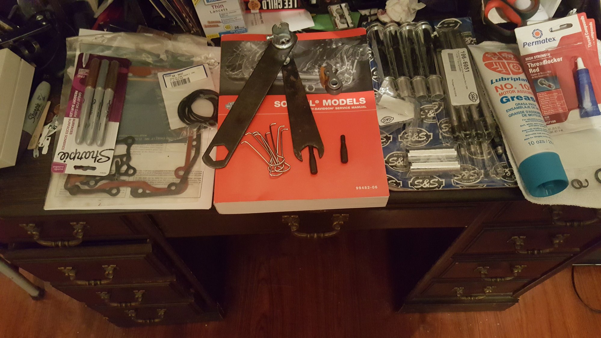

I confronted independent motorcycle shop guy and he tried to claim that his brother was helping him and he thought his brother had put the new cam chain tensioner in the tool. Which I call b******* because even the homemade tools on YouTube have the face exposed you know if it's used or not. I got most of my money back so now here I am and you can see the picture with all the stuff I got to do the job. I am not going to replace any bearings unless they look bad I'm not going to press out the cams. I'm just replacing the inner tensioner the outers already been replaced like I said above.
I welded up a tool like on youtube to remove tensioner without having the cams pressed out.

Don't by the Fix My Hog videos; totally agree with Nomadmax on that. If you feel you need some guidance, take advantage of his offer to discuss the project. Looking at your tool it would appear that you could modify the handles so you can lock the handles when the tensioner is unloaded. If you do that, you can remove the tensioner without removing the inner cam chain and the cams will stay "timed". If the inner cams are aligned, dot to dot per Max, it is impossible to disturb cam timing. Both the rear cam and pinion sprocket can only be installed one way. Take note of Nomad's comment on the camp position sensor, if you have pre 2001 model.
I see the oil pump alignment pins and and the Service Manual, the pins are good but use them in conjunction with the pump alignment procedure in the S/M. Per Nomad, oil pump should be installed separate from the plate, primarily to insure proper fitment of the oil pump spigot into the crankcase scavenge port; getting the spigot in the port properly and with a new o-ring will minimize the potential for sumping which often results from a first time cam/plate/pump R/R. BTW, don't see the scavenge port o-ring or the cam plate to case o-rings. I also see the spring clip chingaderas to hold up the lifters as well as rocker box gaskets; the spring clip holders have a way of letting go at the wrong time and letting the lifters drop so having the rocker box gaskets handy is a good idea. The magnets work to hold up the lifters.
I don't disagree with Nomad on studding the two doweled holes in the case but don't believe it will be necessary. I have changed cams in both my bikes several times in a season looking for the right cam and have never stripped one of those holes but I have always torqued those two fasteners to the lower end of the torque spec; not a bad idea but IMHO, if the low end of the torque spec holds with a bit of blue Loctite, all good.
I to think it a mistake not to replace the OEM INA inner cam bearings with a set of full compliment Toyo/Torrington bearings. The parts are cheap and you will be kicking yourself in the *** if one of the OEM bearings fail down the road which will result in major damage and they have a history of failure. Not a pandemic but why take the chance.
Assume you are replacing with CYCO tensioner? If the outer that was replace is OEM, it should be changed to CYCO as well.
