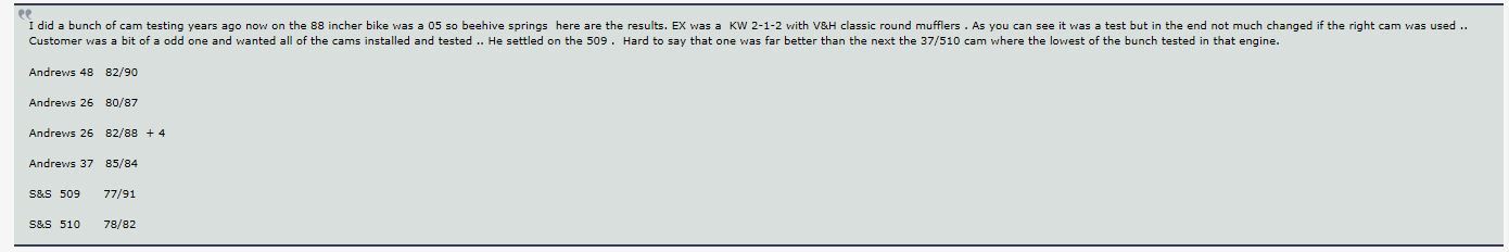

Having run .570" lift cams on '05 beehive springs in a pretty stout 95" build, with no issues, I still maintain that with "mouse" cams, you are not taking advantage of what the stock heads have to offer with higher lift springs and better breathing. Your ride, you decide. As an FYI, I have attached dyno results of back to back tests of a few of the cams you are considering; the only change was cams. If you want to stick with "mouse" cams, the results might give you some insight.
I have also attached a chart showing head flow of 2002, 2005 and 2006 OEM heads out of the box. As you can see, the flow of the '06 heads is much better than previous iterations and although flow flattens at .500" lift, it is still flowing the same at .560" lift.
