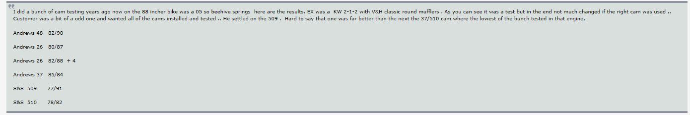

FYI, the 21 is not included but the 25 +4 should be pretty close the what the 21 would look like since the profiles are very similar. The biggest difference is that the 21 intake closes at 30* and the 26 closes at 35*. The numbers might help with the OPs decision. One thing the numbers make pretty clear is that the 510 and the 37 probably shouldn't be on the list.

Looking at that djl the 509s would be the way to go. I don't see the Andrews 21s on there, but suspect they are in line with the 509. Would either of these be/feel that much different from each other? If those two cams are that close I would think price would be the determining factor then.
Read the post and look at the 26 +4 results. Rigidthumper is right about a displacement increase. Just going to 98" with say 9.6-9.8 static will feel like a different ride. Add a bolt in cam and another jump in power.
