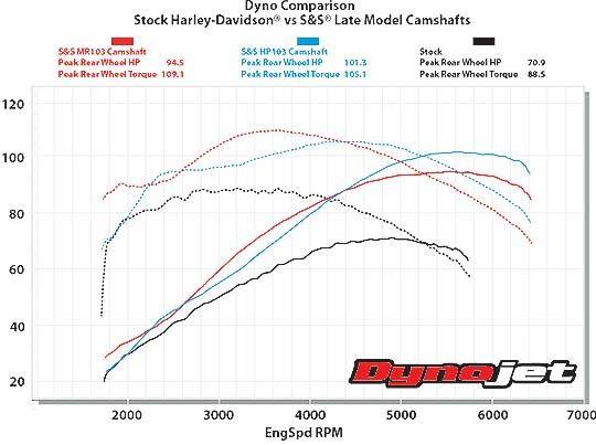

The S&S MR 103 cams are a good choice for what you're looking for. Over 100 ft/lb from approx 2300 rpm out to just over 5000. S&S designed these cams specifically for the stock compression, stock head 103 as bolt in cams.
FWIW, if you're planning on getting a dyno tune, talk to whoever you are using for recommendations. Different shops it seems like certain brands/types of cams for whatever reason wether it be their experience/results with those brand, or, maybe they are distributor for a certain brand.It can make things easier as i'm finding out. 1 shop says the cams are a terrible choice & a PITA to tune, while other shops recommend & install them frequently with great results, claiming they are very easy to tune.Again, it's based their experience & results.

Just for reference

Definetly looks like good power from those cams & would be a good choice. I wasn't claiming tho that 1,or,the other is better.You had mentioned that there was no info on the MR 103's in the files,so,i thought I would post what I had just so that it was available if he wanted to look into it. If I had to choose again,I would definetly consider those Cyclerama 570 cams.

The dyno starts at ~ 2300 so the off idle area isn't shown and the graph is very compressed which will change the looks compared to ones that are not so compressed. The results of 92 Hp and 118 Tq are in the expected range for a nice bolt in cam with exhaust and Air cleaner, there are many that will get you those results. The main thing is if your happy that's all that matters.
