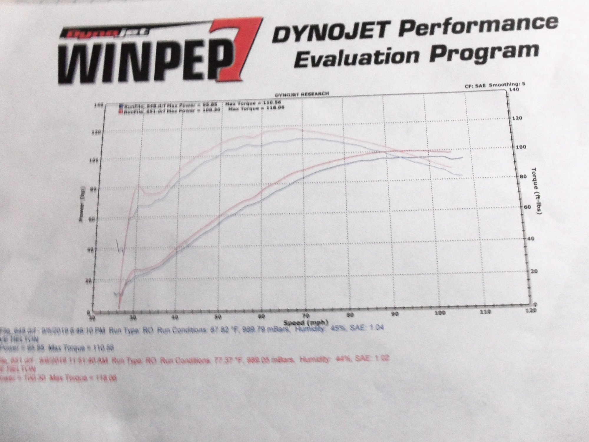

Got it tuned runs good 101hp and 118tq no hesitation but have a slight decel pop not bad but wish it wasn't there.
Love to see the dyno sheet...
Looking at your sheet it appears you are hitting peak torque between 3,500 and 4,000 rpms. Is that correct?

From: Big Rock Va.24603
Yes i looked at other cams but couldn't decide on one.I already had the cyclerama installed so i just went with it.

The posted chart is not typical of the Cyclerama cams which usually will hit 100TQ around 2400-2600 rpms. Motor should have plenty of compressio with CCP up around 200psi but maybe heads and exhaust are affecting the curve. Wouldn't expect the peak numbers to change much but those cams with all the other parts working together usually produce a much better curve. The comment about decel pop could mean a better tune was possible but could be a separate issue, like exhaust leak, etc.

Checked exhaust and intake no leaks may be the tune.
How did you check the exhaust for leaks?
