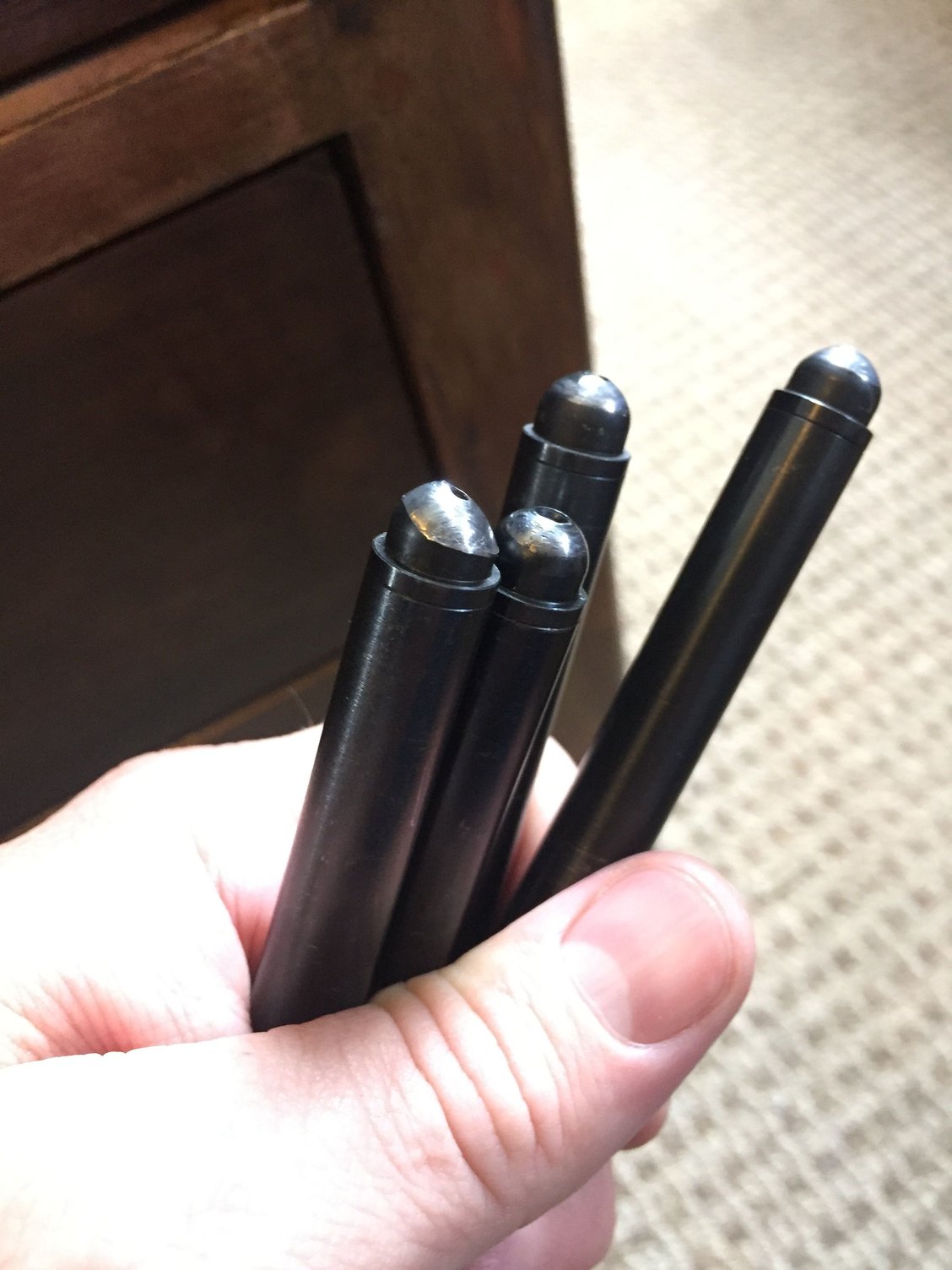

I ride a 2001 Road King Classic FI with 36,000. Last fall I had the cam tensioner upgrade done (SE hydro) and new adjustable pushrods and lifters. I rode the bike home and noticed a loud tick or knock at idle once the bike was warm. Took it back to my indy and he told me it was old parts and new parts working together. So I rode the bike... for another 2000 miles. Took it back to him this summer because the sound was still there. No worse, just still there. He acknowledged that this was not normal and pulled the pushrods to find one of them (rear exhaust) severely worn. Two others had moderate wear and one (the front intake) looked good. He attributed it to cheap pushrods and swore he would never use that brand again. He replaced them with S&S quickee pushrods. The sound was still there, so I changed the lifters to S&s, thinking that I might have a bad lifter. No change. Now I am thinking that I may have an oil pressure/flow issue, but I am really grasping at straws.

I have never seen a push rod worn like the one on the left side of the OPs photo. Just a couple of thoughts/suggestions. First thing I would do is pull the rocker covers after running the motor for a few minutes ans see if oil is pulled in the corners of the lower rocker box. If flow is good, there should be pooled oil. Next, I would start the motor and watch/video oil flow at the rocker arms. It won's spray all over like a small block Chevy but will dribble through. The HD oiling system is based on flow/volume, not pressure. There should be an immediate and constant supply of oil between the push rod and rocker arm. If not, the oil supply to the top end is the issue and the solution is likely in the cam chest.
Apparently the noise did not present before upgrading the cam chest so it would seem that something in the upgrade is the source of the noise. Llike Mattbastard has inquired, which SE cam plate/pump was installed? The OP has not told us what oil pressure is, at idle and cruise which is pertinent. A video of the noise would help as well as knowing oil pressure.
