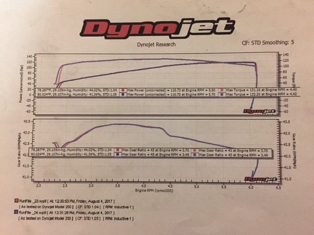

I can post mine, although you weren't quoting mine. 130 TQ isn't hard to do (not easy either, just takes some good heads, exhaust, throttle body).
Granted, I can't find the copy that is in SAE. This one is in STD. But the numbers are in uncorrected on this one too. So about a 3-5 percent lower for uncorrected, but in STD, about a 3-5 percent increase as well. So a wash. My other run by the tuner in SAE shows 131 TQ and 121 HP. No number inflation here either as he is one of the most legit and best tuners out there.
And I respect your asking for the sheet and know you've had one of the nicest built 110's when they first came out.

Wow I’m confused, help me understand. I see 2 runs both with STD 104 and STD 105 then uncorrected beside it? Uncorrected would be 100 not 104/5. Then you say the SAE which is not shown has higher hp than this sheet by 5hp. These runs say STD 104/5, how can it also be uncorrected

Well, I can mail you the original SAE dyno if you’d like. Or you can talk to BVBob, one of the best tuners out there. 131/121 when a cam swap and new muffler on the re-tune after this. Corrected. SAE. 130 is not insanely difficult on a 107 street motor. Not easy easy either. As I said.
