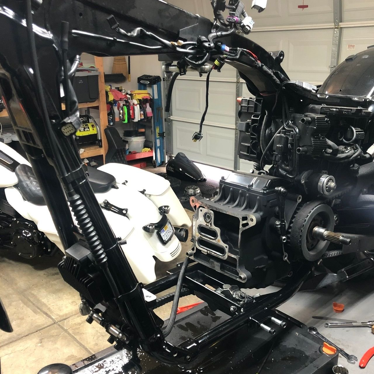

Got the lower end out of the chassis today, it’ll be heading over to have the crank done, timken conversion and have the cases bored on Tuesday. Slowly making progress!
