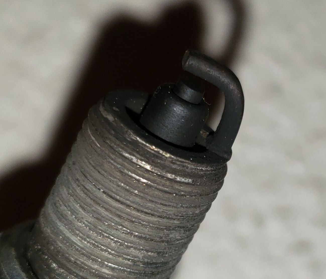

So did compression test. And I got tick under 120 in the front and about 125 For the rear. I Attached pic of front plug, but both looked same. Front was a tad more shiny but I couldnt tell if it was wet and then dried up over the last 2 months the bike has been sitting. Definitely wasnt wet to the touch. So I button everything up, pop some new plugs in and it fired up. Did notice another problem. The lights going off and bike going dead when I hit the start was a result of something ground related. I have a new battery, and a brand new battery cable. I wiggle the negative cable and bike lights come back on. Hit start they go off again. Had it running for a min and see a little mist of smoke. It was negative cable melting the battery terminal. Last year I replaced the regulator and coil. Could the actual ground to the frame be causing this?

Rich condition and/or retarded timing, or both.

Forget the plugs for now. Anytime you cold start one (using the choke/enricher) the plugs will look just like that, even if you just put new ones in. You have to ride at least 20-30 miles in most any weather for the plugs to get hot enough to "self-clean" like they're designed to. Also, even a low mileage, perfectly healthy bike will do what yours is doing if all it ever gets is started and run a few minutes with out riding, getting it up to operating temperature. You might have few more little things going on but best advice is (for anyone) - if you don't have time and weather to ride one at least 20 - 30 miles - don't start it.
