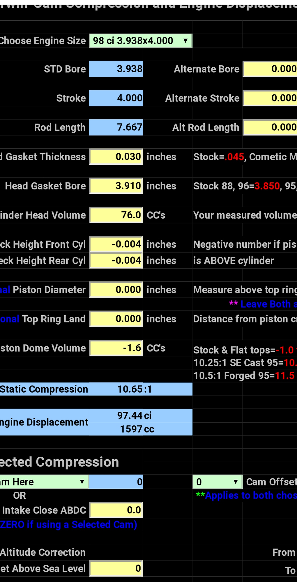

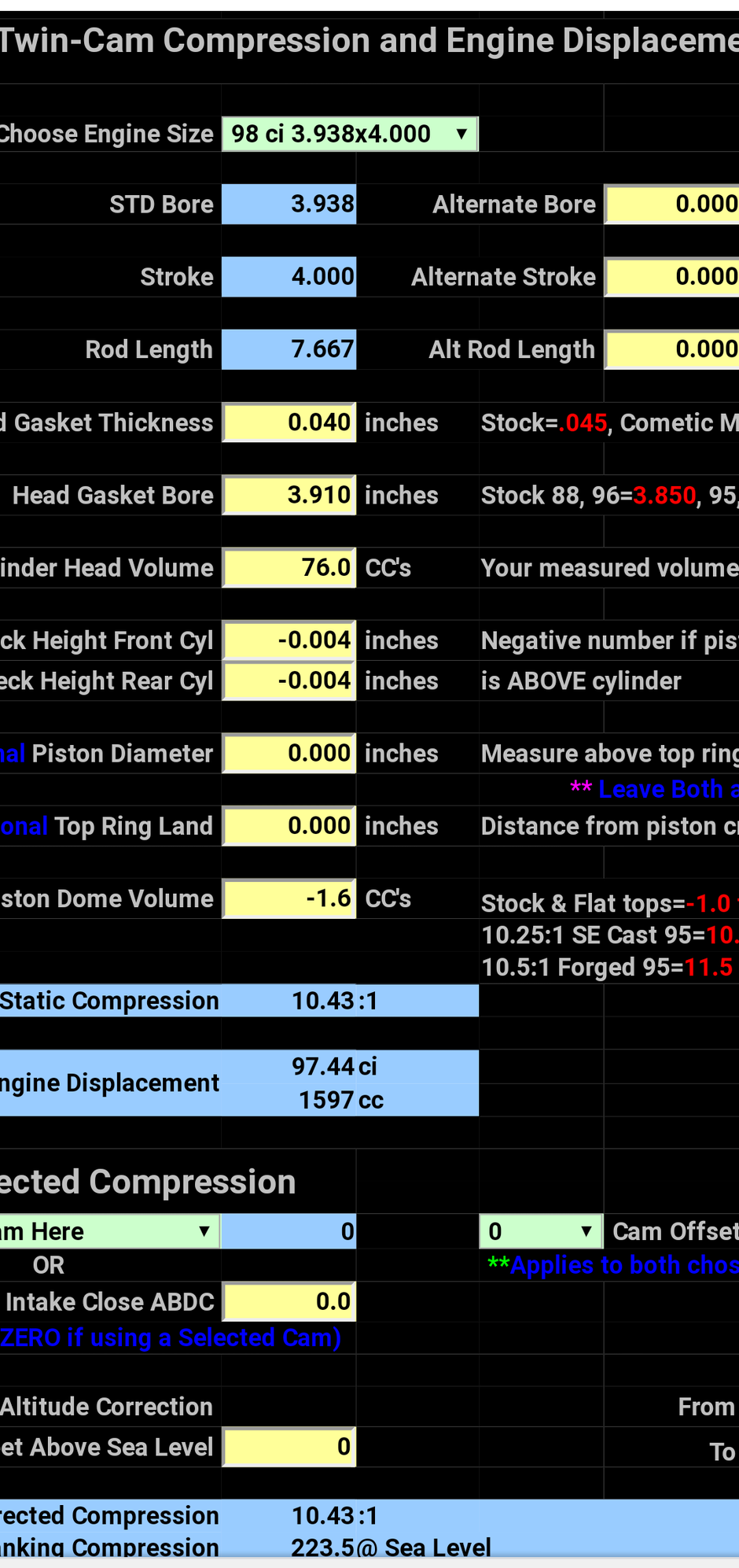

10.35 is just about where we land with that 6H here, on an injected bike.
Been using those since 1996, when Wood emerged on the motorcycle scene.
Scott
