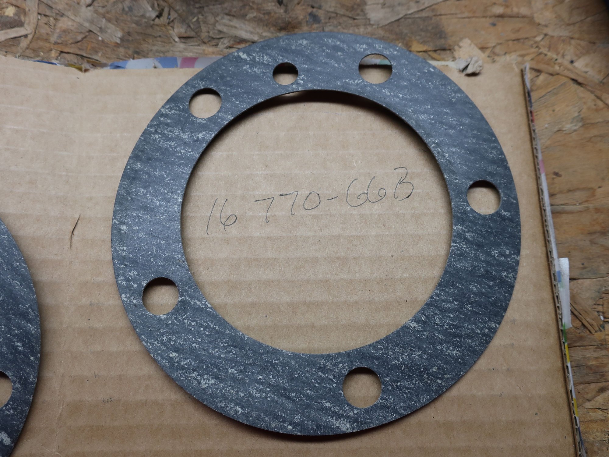

Nothing on them. I'd recomend using Cometic MLS gaskets tho. Unless you have a true, OEM abbesto's head gasket but those a rarer then hens teeth. Post up a picture of said OEM gaskets.

Default head and base gasket
head gasket
base gasket
These are the gaskets purchased Chopper.
