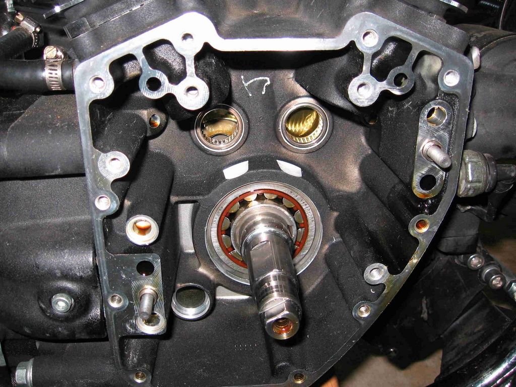

On twincams, the main reason for smaller base circle was to provide clearance between the main bearing boss and exhaust cam lobes on 99 to 02 tcs. On real high lift cams, they were needed to clear the lifter bosses and with chain driven cams, they were used to keep the cams from colliding with each other. On a M8s it's probably less of a worry about the cam hitting the engine case on taller lifts. When I changed cams on my 17RK, I went with adjustables just so I could replace the lifters without pulling the rockers. Care must be taken when doing M8s as the top tower that hold the rocker shafts can break off if the rocker arm is cocked while cranking the shaft back into place with fixed pushrods. The tower is machined directly into the head so the head will have to be replaced or welded.

Which is why, even some smaller base circle cams for the early TCs required some dremel work to run .600" cams.
