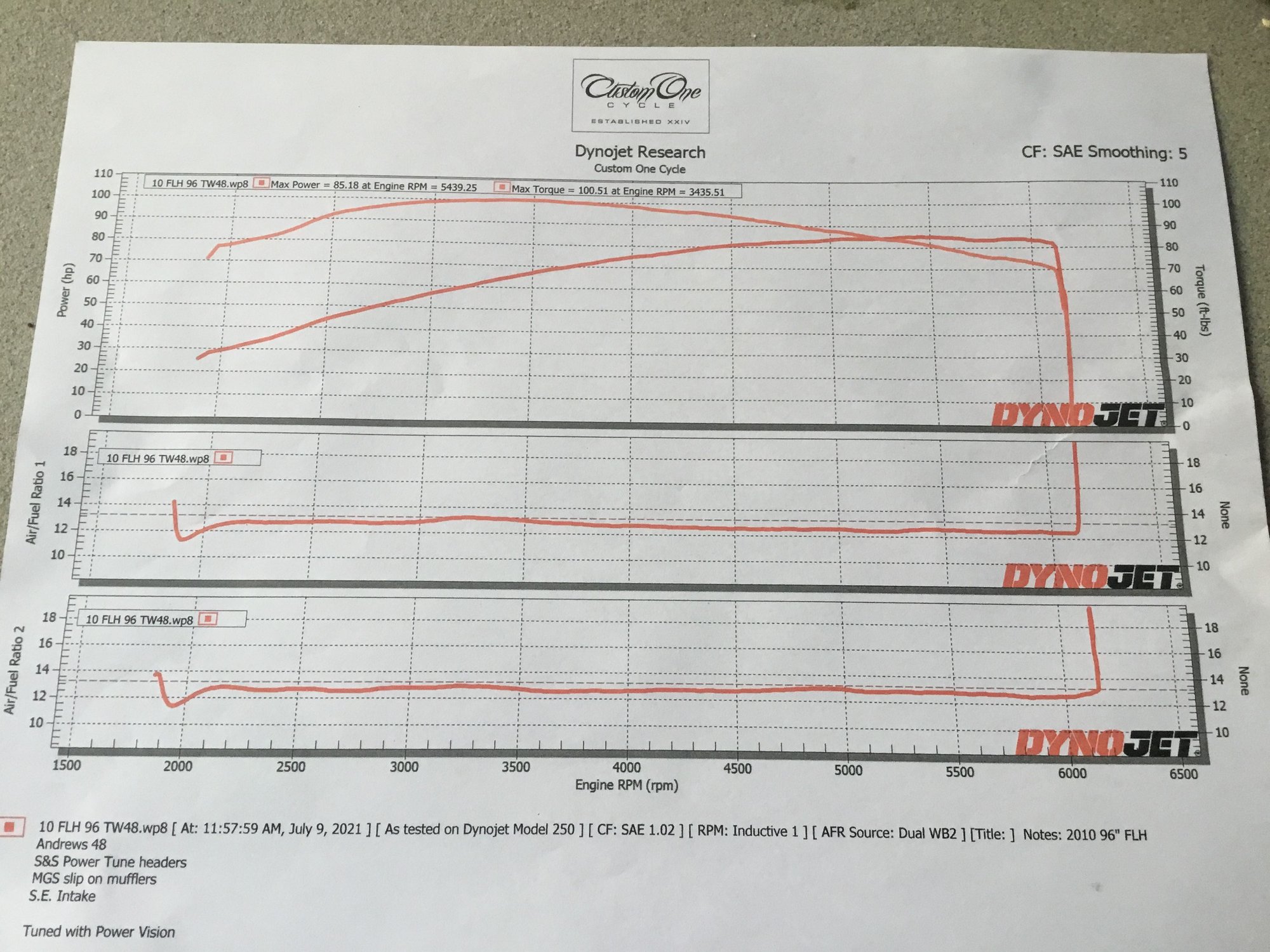

Here’s a shot of the dyno results. Doesn’t look lean to me but I don’t like the symptoms. Going to give the shop a call this morning.

you have to remember that when viewing a dyno graph like the one that you posted, you are only getting a view of what goes on during a 100% throttle, SWEEP, test. this shows the info that goes on dring THAT test only, it does NOT show what your idle mixture strenth is or what your part throttle cruising AFR values are. they have to be graphed in a bit of a different fashion in odrer to be printed out for you and also a bit of explanation is invovled.
as far as that graph, it looks pretty good so i would say that is one thing that you could cross off your list, not likely the cause of your issue.

You're obviously running lean and need to do an auto tune on your power vision. As stated by another member that's a hundred percent wide open throttle pull, says nothing about your low and mid-range operation.. 60 mpg is way high.. Hi heat activated the EITMS......
