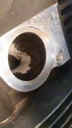

Pulled the induction module off the motor this past week and found a problem with the rear seal.
The brownish yellow is oil. Contacted my Indy with regards to integrity of the heads, specifically the valve seals.
He assured me that if the seals were bad enough there would be blowing smoke out of the exhaust and have a drop in the engine oil levels. Considers the oil to be coming from breather blow by.
Got the seals changed out and things seem to be running much better. The rear top end knocking seems to be gone and it seems that we are at an acceptably level of vibration.
I don't know if we are at 100% resolution of "My Problem", but I think it's going to be OK.
This seem to have been the real root of the problem. Would like to take it for a ride, but it may be a month or to before the snow is off the ground here.
Still questioning the non OEM map sensor. Service tec at the Dealership advise against using anything but Harley sensors.
All in all I am hopefully that this is pretty much " PROBLEM SOLVED".

Are you aware that HD heads have powder coating in the ports and combustion chambers and as the engine runs it gets dissolved into the engine - leaves it looking exactly like what your pic has. Just an FYI.

I did not know that.
Just posted the picture to show the surface where the seal had been leaking.

Didn't want you worrying about port that if you were.
