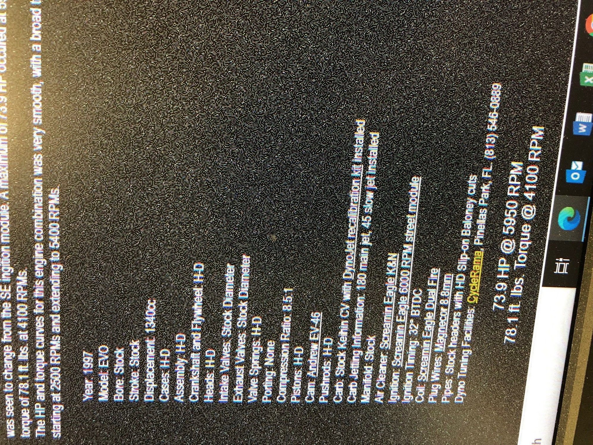

Maybe review the information on the nightrider website? I've always found it informative.
http://www.nightrider.com/biketech/hdstage2.htm

I would keep the CV carb and install a Thunder slide kit. Go with the jet that your builder recommends. (Ev-38 or Ev-51 cam) with stiffer valve springs, and Jims roller lifters. High compression pistons may affect your choices here. You may as well get some headwork like porting done here too. Or shell out for some aftermarket heads and matching pistons. I would guess you would easily be in the 80hp plus range after this. Good luck!
Dynojet Thunderslide Jet Kit For Harley Big Twin Evo 1990-1999 - RevZilla
And a hotter single fire ignition if you don't already have it....even the Screaming Eagle S/F ignition and coil will work well here with your RPM limitation.

Thanks for that Good reference point
