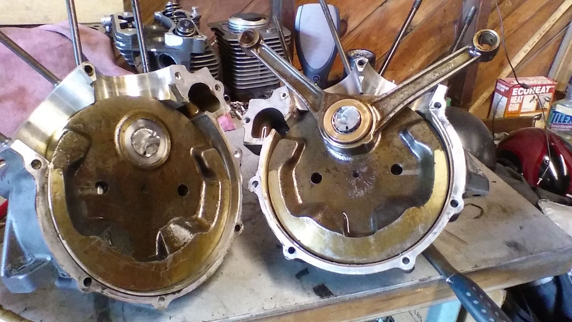

[QUOTE=98hotrodfatboy;20369577]Not sure the crank pin will hold up that long... I had mine at 97/97 and it sheared the crank pin..
No matter how many times I see that pic, I still cringe ..

[QUOTE=eighteight;20369728]
​​​​​​ Yeah me too.. good thing I was drunk when it happened. A little easier to accept..
Who makes that crank?

Ouch, that hurts. Drunk or not that hurts! 97/97 in an 80 is rockin. Part of me would like to have an 80 to build. Always wanted to do a hard tail chopper around one just for fun. My achin' *** body wouldn't be able to ride that horse for long but... be fun to build and hot rod around town on once in awhile.
It was a stock crank. Good for 60/70 if you want any kind of reliability..
