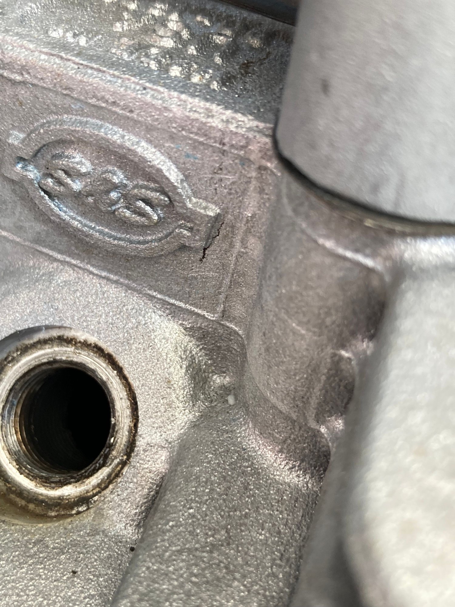

Is it a crack or simply a oil leak from the rocker box?
Whoa... I don't think so... I'm going to have to get out my magnifiers tomorrow when it's daylight and I can open the garage door. Man, I'd be thrilled if it were but... well, we'll see!

Sorry for the delay. I wiped with a rag soaked in some Simple Green and it looks like a little crack, as you can see--though the balance of it came off...
What's weird is that there's no evidence of oil leaking from the valve cover I can see, so I don't understand how what Maxheadflow rightly identified as oil extended upward from the crack... or maybe by coincidence it ran down to meet it somehow?
Guess I should take a brass or stiff nylon brush and scrub with some Simple Green to see if my eyes are deceiving me. But it sure looks like a crack...

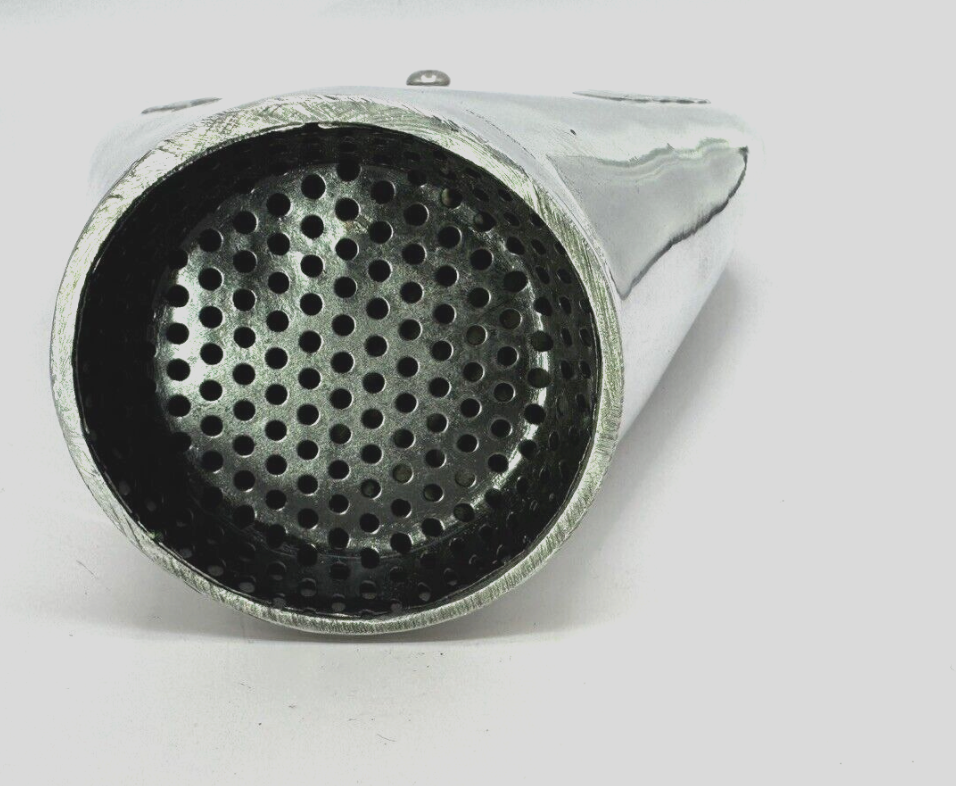

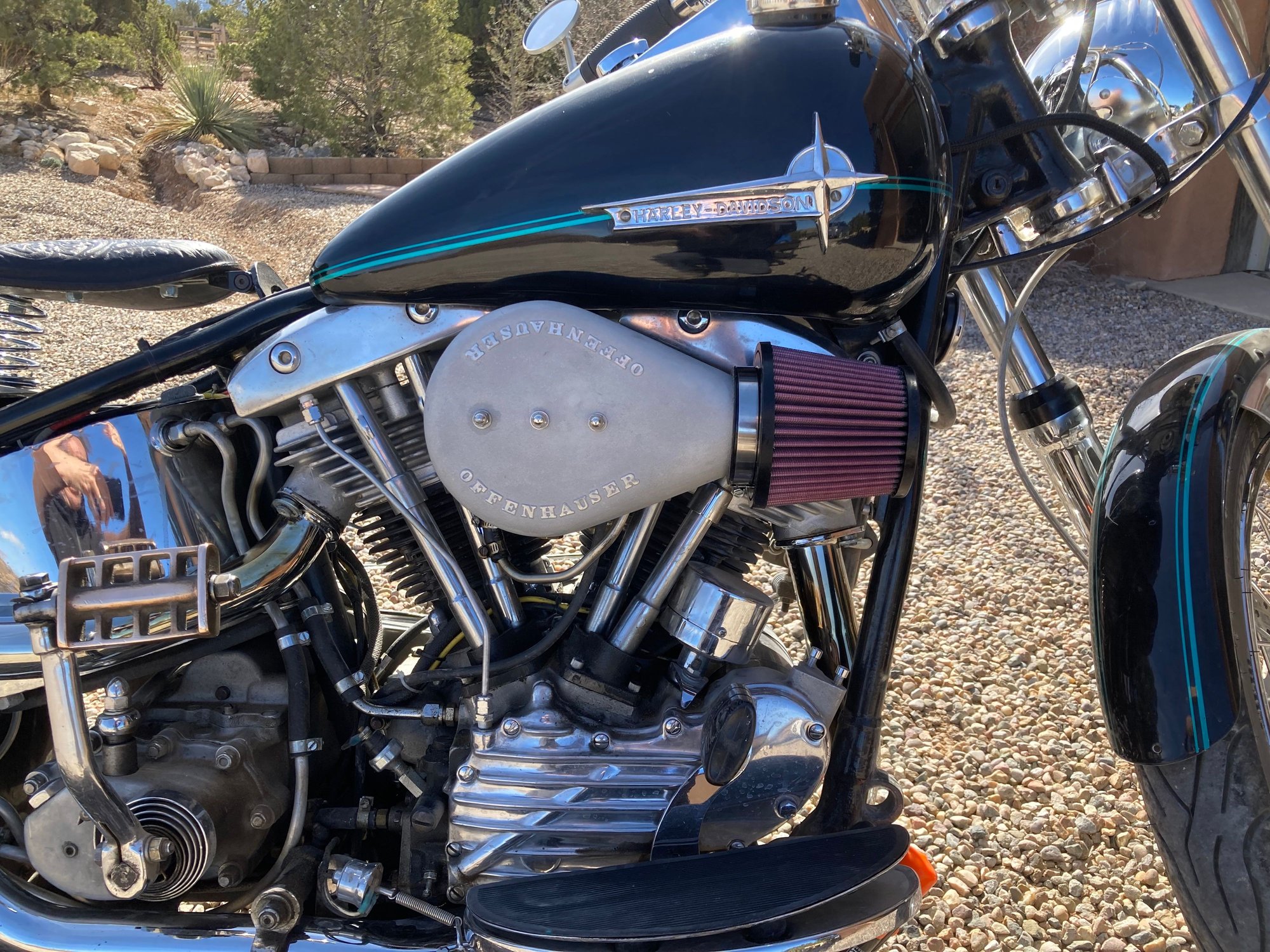

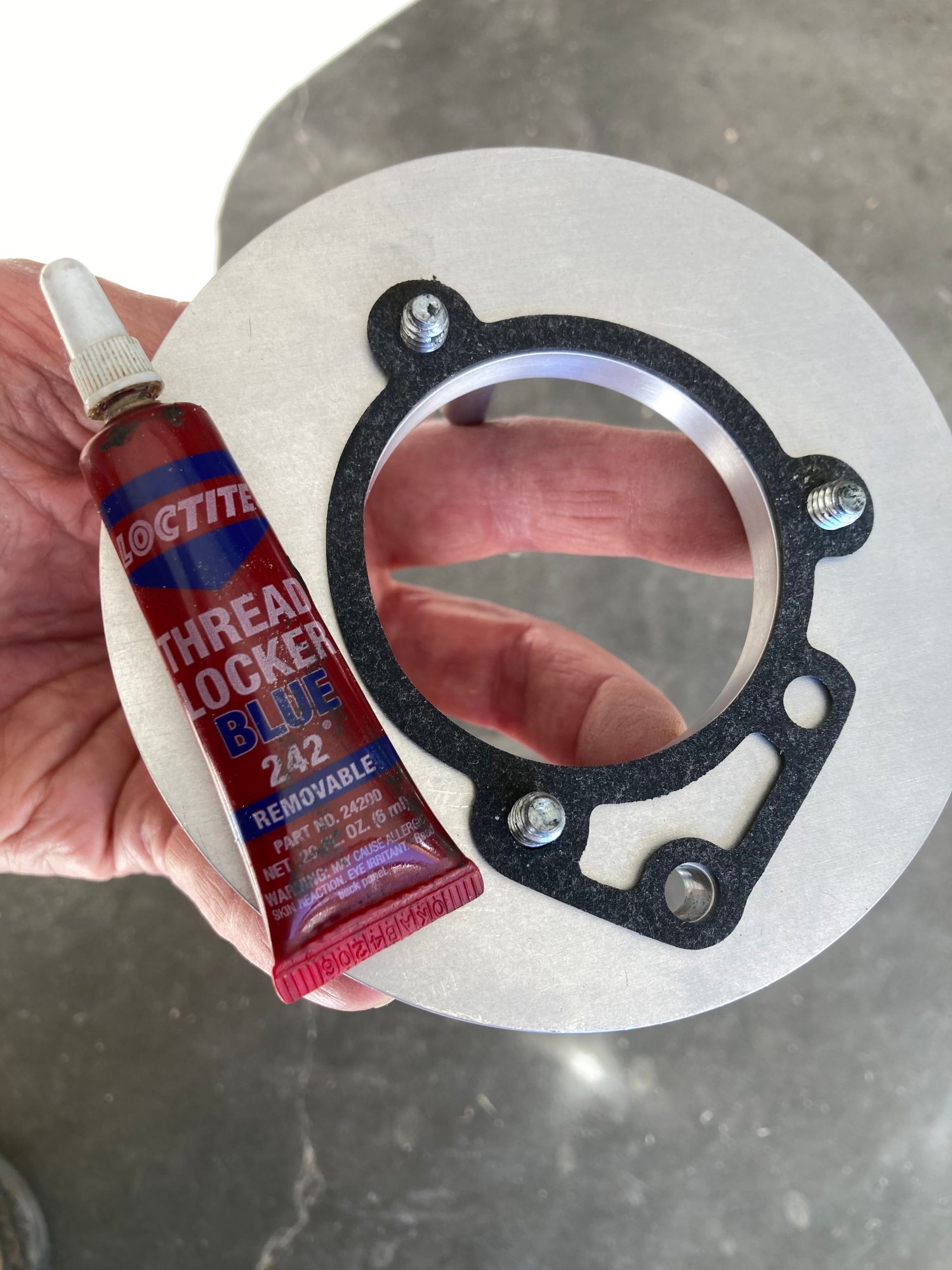

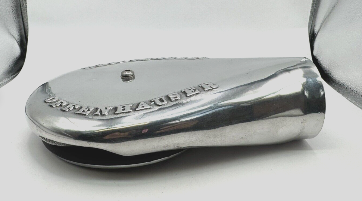

Originally Posted by Gordo-uk
Looks like the same Offy air horn but evidently some guy just sanded and polished it, then attached it to a cruddy tin base and wedged a perforated metal plate into the inlet. It seems to me unlikely to flow anything like the amount of air the engine requires. Probably just for show...?
Compare the first three photos--his crude setup--with the following three pics of what I produced. The chief difference is my design and execution are form-follows-function vs. his approach, which is precisely the opposite.
Incidentally, I'll be selling my prototype whenever I get around to rebuilding my Pan-Shovel's bottom end next year. I have designed a new, more traditional-looking circular low-profile unit using an extrapolation of the same base you see here. It's very sleek, polished aluminum, and yet retains the knee-to-tank goal of the Offy setup I came up with.

From: New Mexico
BTW, what he's asking is just... well, to my mind, outrageous for what he's produced. Especially because the bike is going to run like c*#@p with the thing installed. While looks are subjective and someone may or may not like the Offy air horn (polished or unpolished--just a matter of a day's work), my setup flows great.
The only downside appears to be a slightly increased tendency to vapor lock on very hot days at my altitude (5,000~6,000 ft), with the corresponding thin air. That's another reason for my new design, which doesn't create a kind of culdesac, if you will, which retains vapor when the engine is sitting still.
