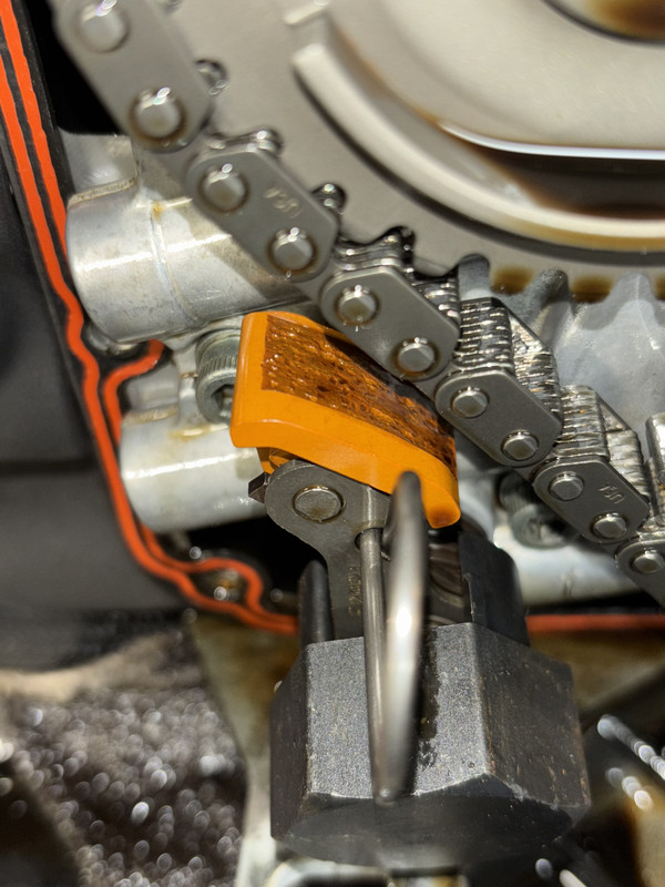

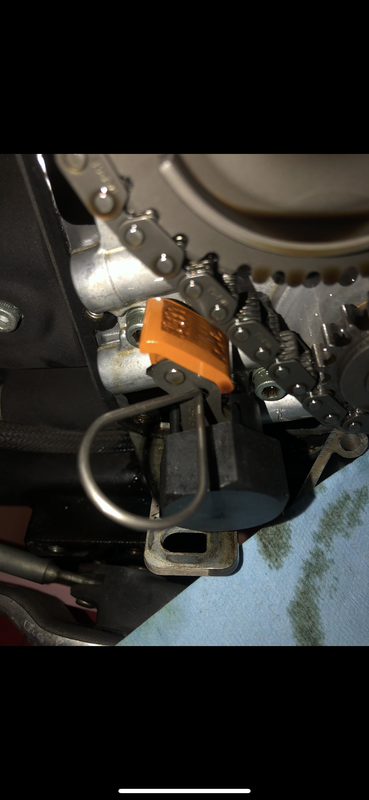

I'd like to gather some recommendations before getting any further with my 20k mile 1999 FXDX. I inspected the tensioners at 10k and the wear was not bad at all. Now, at 20k, the outer pad is not awful but the inner is more than I'd like to run any further. Time to address them.
I bought this bike used with no paperwork. It was dyno'd last year with 98 hp/98 tq. Dyno tuner says it definitely has a big bore kit/cams for those numbers. Not sure what cams are in it but the outer cam gear is marked Andrews. I was quite surprised to find the bike does not have adjustable pushrods. I'd figure with any motor work the builder would have installed adjustable pushrods but I guess not.
I was in the rocker box assembly last year, updating to the newer stamped breathers and replacing leaky gaskets. I really don't want to get back in there! Any recommendations on a quality adjustable pushrod? I'm thinking S&S here.
Also, beginning this last riding season, the lifters started to make cold start up tick. The noise goes away very quickly but I think now is the time to replace all the lifters. Suggestions here?
I am aiming towards Cyco tensioners and keeping the cams I have. Love the way it runs and don't want to mess up a good thing. Being a 1999 I will verify it has the updated outer bearing and see if it has Torrington inner cam bearings. If so, I don't plan on touching them.
Any other suggestions before diving in?
Outer pad at 10k:
Outer pad now at 20k:
