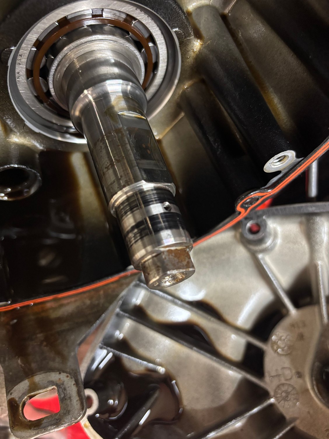

Can anyone recommend a good hydraulic cam plate upgrade kit? Cams comparable to the TW50? I love the way these cams perform they are an animal on my bike. Maybe I can stick with TW50 but go with the newer splined?
Anything to watch for going with the hydraulic kit on a 1999? 1999 seems quirky!
Also, should I be concerned with this pinion shaft wear?

Heck, you should be able to get conversion cams in TW50s from andrews.. In that case you can use a take out 07 up cam plate with the hydraulic tensioner.. You will have to plug the balancer oil passage but you'll have to do that anyway on any new plate.. Most cam plates kits require that you use an ignition module that does not use a cam sensor.
