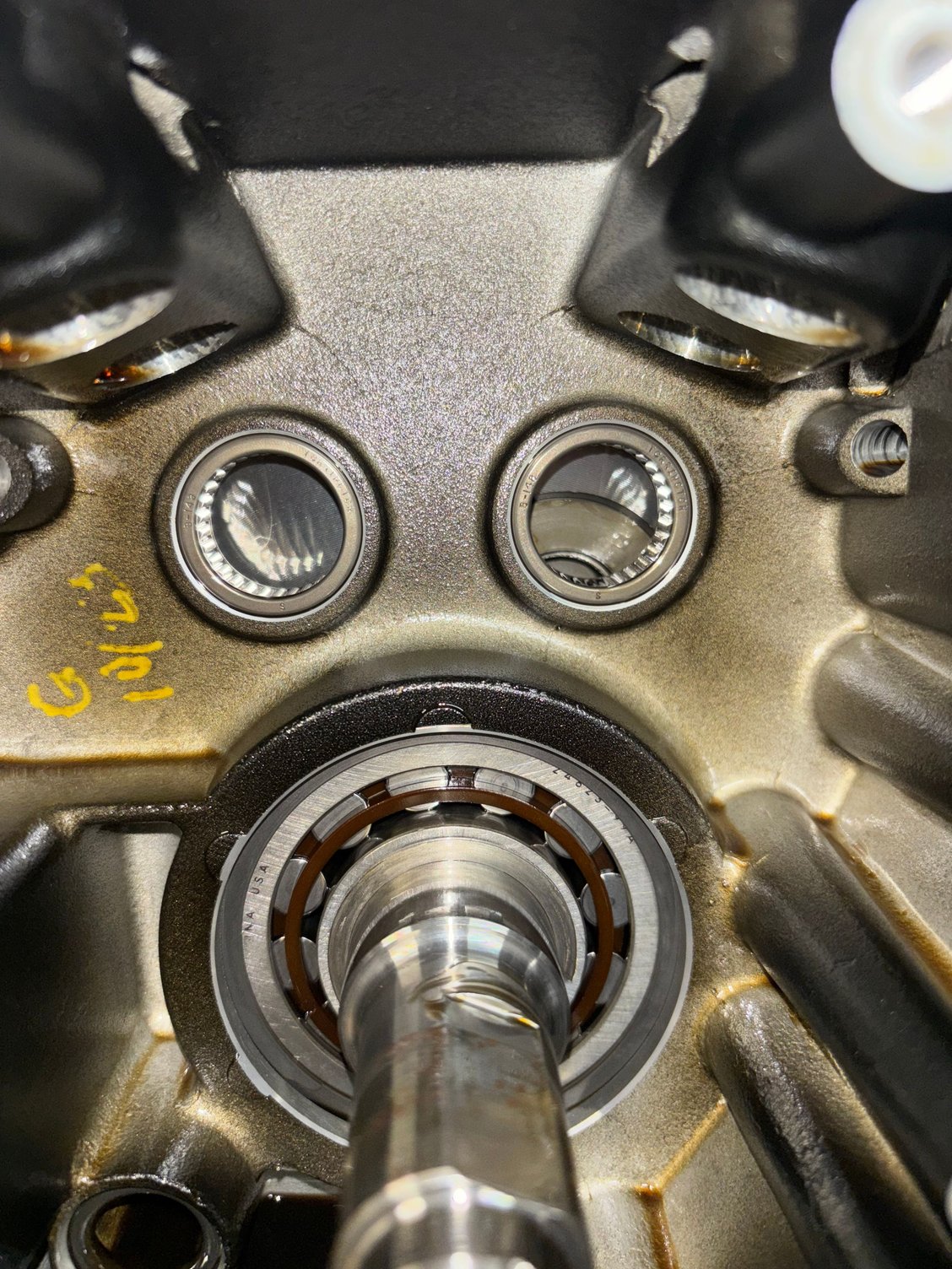

Was able to finally get the cam sprockets off. This bike unfortunately still has both ball bearing outer bearings. Also the exhaust lifters don’t look great… I will post pics later on today.

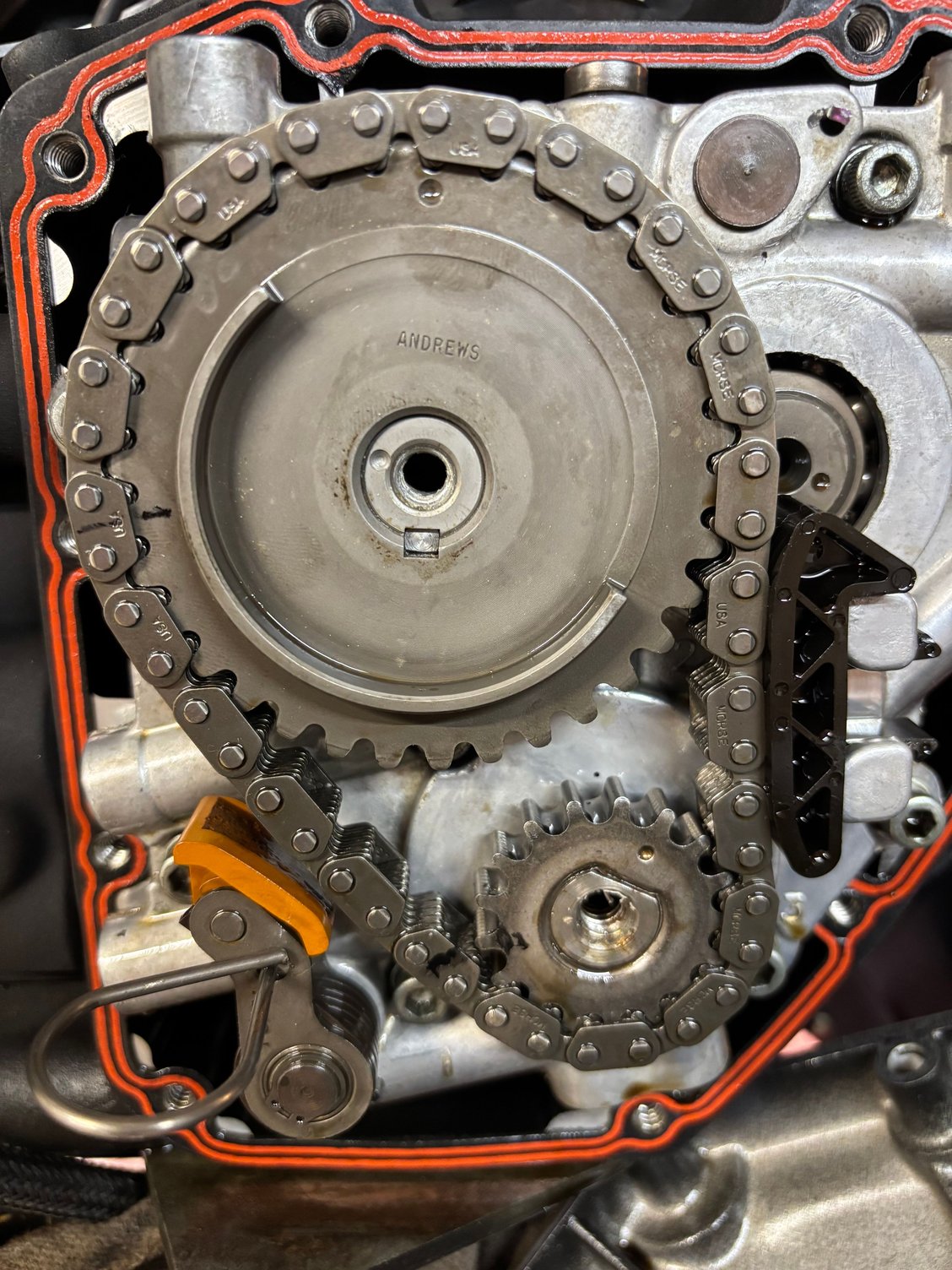

This is where I stand now. I can't get the cam plate out. All 6 bolts have been removed. Something is not right here. All videos on this I have seen the cam plate loosens right up when the bolts are removed.
The tappets have decent wear (I will post pics). The rollers roll fine.

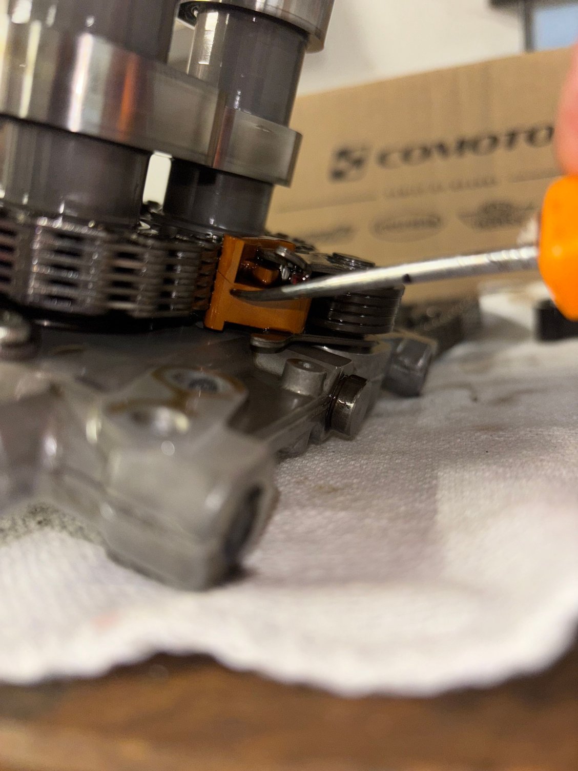

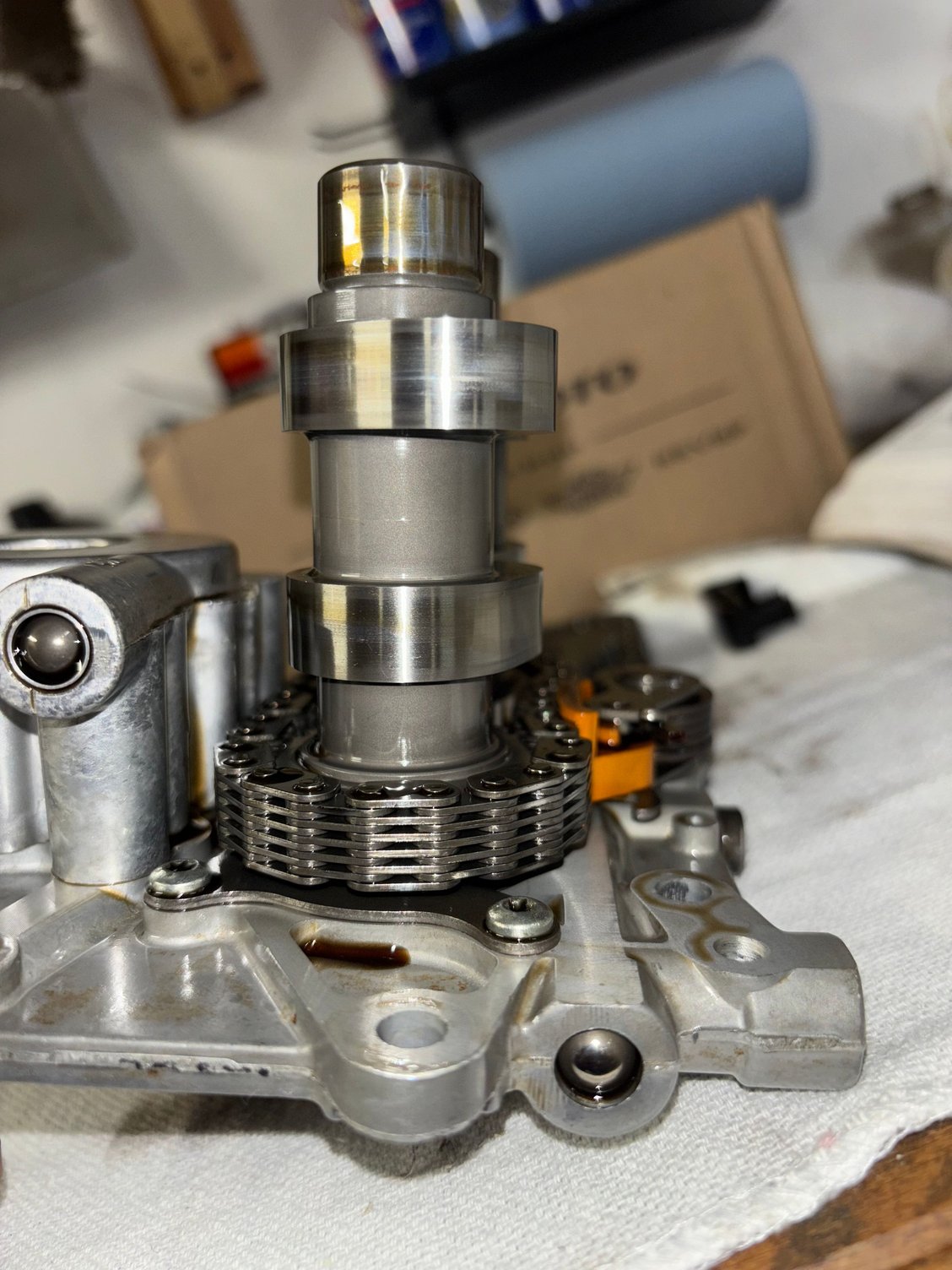

Ok so I got the cam plate out with *gentle* prying. I am glad I am doing this... the inner shoe developed a crack. Andrews TW50 cams. Torrington inner cam bearings already installed by whomever was in here before which is great..... but why did they keep the problematic rear outer cam ball bearing? Weird.
Also, the crank where it runs along the bushing in the oil bump is pretty grooved. Is this normal?

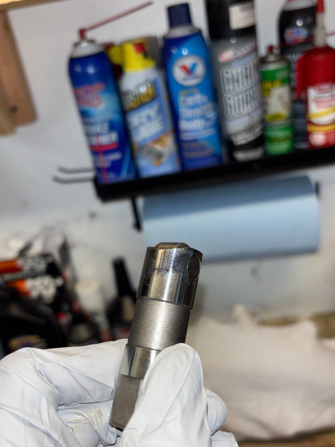

Here are pics of both exhaust lifters. I don't like the wear on them. Suggestions here? I am replacing them of course but why such wear?

I know only 20k on lifters but I would replace since in there. I start to think about replacing them around 50k. Not saying I run in and do it. But I would replace all bearings, and not think about this for 50-70k miles. Breather too.

I came into this with the intent of replacing all the lifters with the S&S Precision lifters. I'm concerned with the amount of wear on the lifters and that pinion shaft though at only 20k miles.
At this point.... I am considering going with the hydraulic cam plate upgrade and new set of cams and scratching the idea of sticking with the mechanical tensioners and Cyco pads. Probably best to mate new cams with new lifters no? If that rear outer cam bearing was already upgraded I would stick with what I have but now that I have to press the cams out to replace that.......
