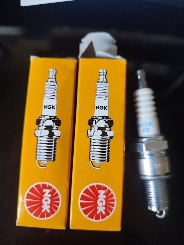

Old Mar 26, 2022 | 06:42 AM
PLANET HARLEY's Avatar
PLANET HARLEY
Joined: Oct 2021
Posts: 96
Likes: 6
From: FRANCE
Old Mar 26, 2022 | 09:10 AM
Jackie Paper's Avatar
Jackie Paper
Posts: 38,726
Likes: 6,491
From: Honah Lee
That's the wrong type of plug. NGK are great and I use them but you don't need fancy iradium type ones. There great for long life in a Honda car but they fowl easily in a bike with a little fowling and weak spark.
New however should cause no problem.

Old Mar 26, 2022 | 09:47 AM
nutsandbolts5212's Avatar
nutsandbolts5212
Posts: 1,426
Likes: 821
From: Shitcago, Illinois
Never had a problem with using those plugs just make sure you gap properly. You might have an ignition/timing issue as well.
Ride safe!
