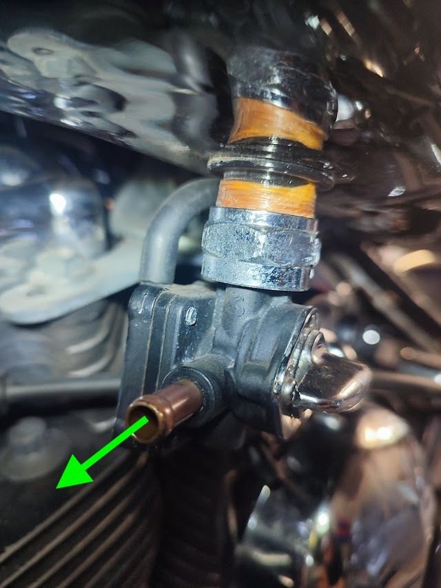

Pull your vacuum hose off the petcock and make sure no fuel is in it. Its best to check the vacuum with a hand vacuum pump.
But in a pinch, put a hose on it and suck till it holds your tongue. It can actually work with a small leak. But if it leaks, it will pull excess raw fuel into engine
Not sure when but late model Carburetor Harleys have a dual diaphragm system like most metrics.
I would check it. You really need to leave that safety feature on there. Especially old Harleys with leaky float seats.

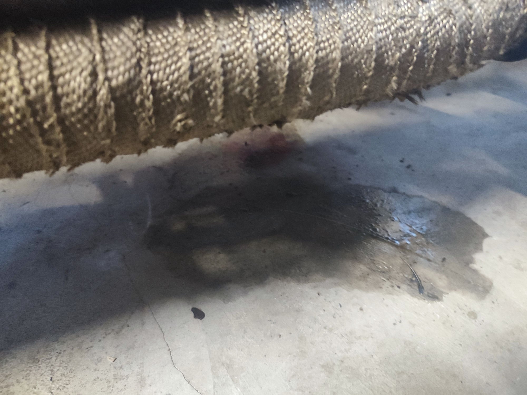

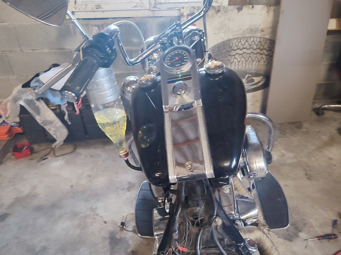

Originally Posted by PLANET HARLEY
​​​​​​You need to respond in your attachments. Is that fuel? Where is it coming from?
