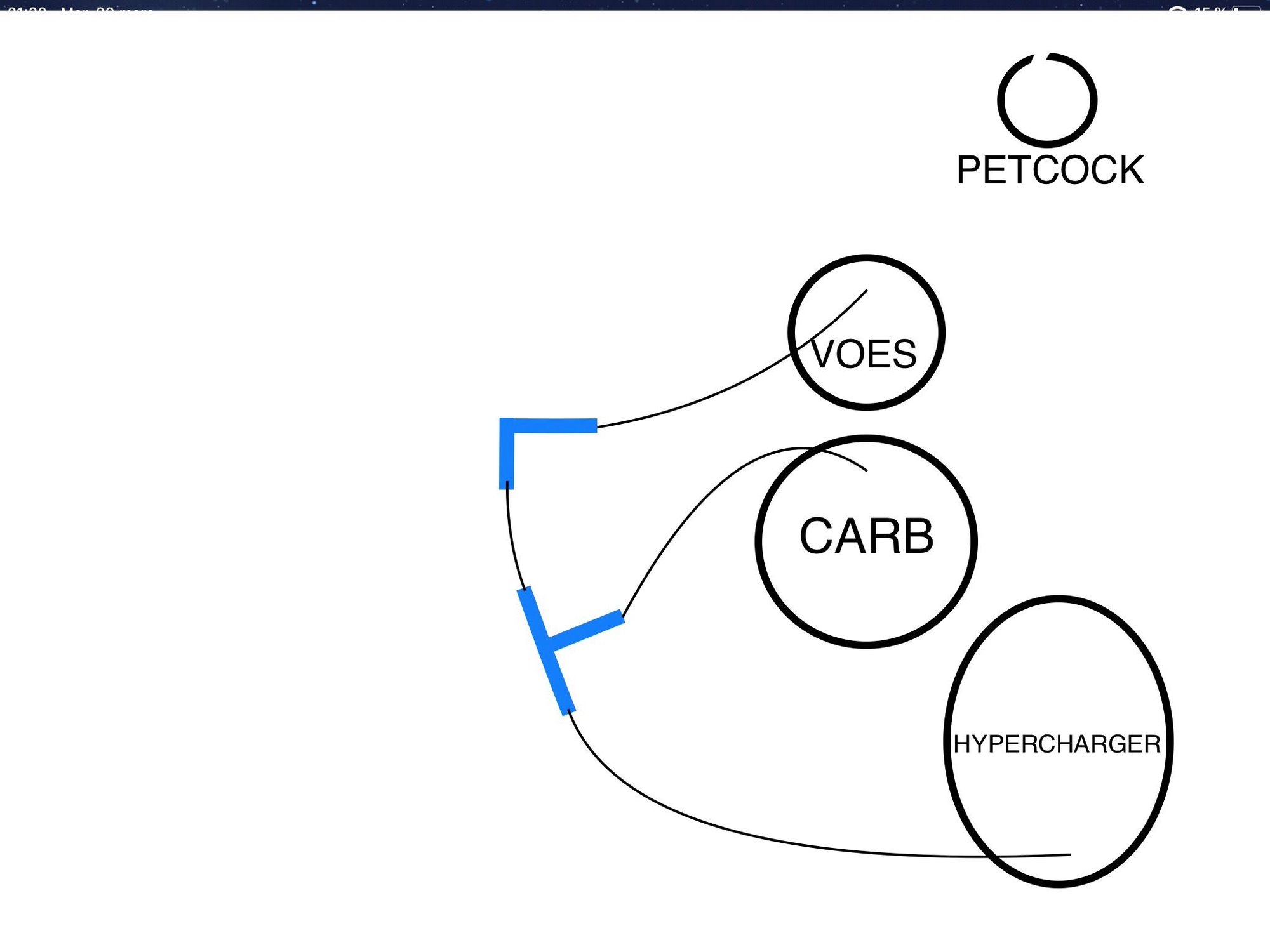

I will remove the vacuum petcock

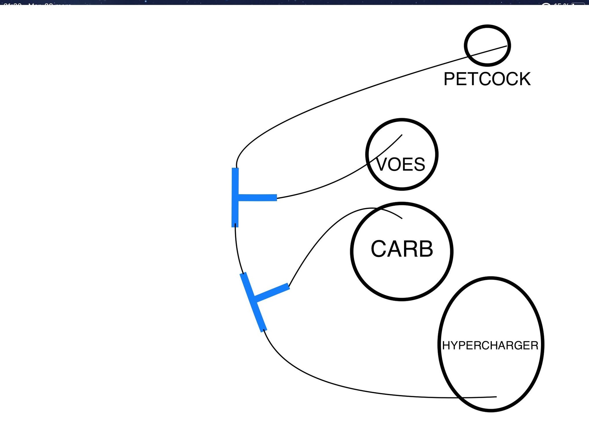

the routing hoses is good like that?
My bike
Without vacuum petcock

I'd think very seriously about trashing the hypercharger, those things are notorious for trouble with vacuum leaks. It would explain a lot of the issues you are having.
