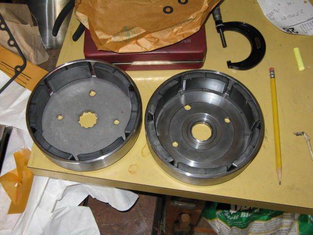

Said this before but if you found the nut on comp tight, it didn't come loose. The 10B spline is a weak point till Harley went to serrations. (They look weaker but aren't since there is a lot less material gone in their design)
The spline strips on either clutchless slam shifts or even hard downshift engine braking.
Then the comp spring drives the alternator for a while even slipping a little until it face wears too much. If it moves over a 1/32 from wear, it throws sprockets out of alignment and in your case even wore the bore out.
Under the extended warranty they just tightened mine twice without checking. The third time, I said screw it and torn it down. It had been stripped for a long time and you could see the sprocket nips on the chain.
Mine was still charging however. I'll post a picture of the face wear.

You can see the wear ring in the face. Spline gone. However not nearly bad as yours. The bolt nut was still tight from the Loctite.
Nips on chain links.
Made sure with bolt nut was tapped far enough. Some have said theirs wasn't.
