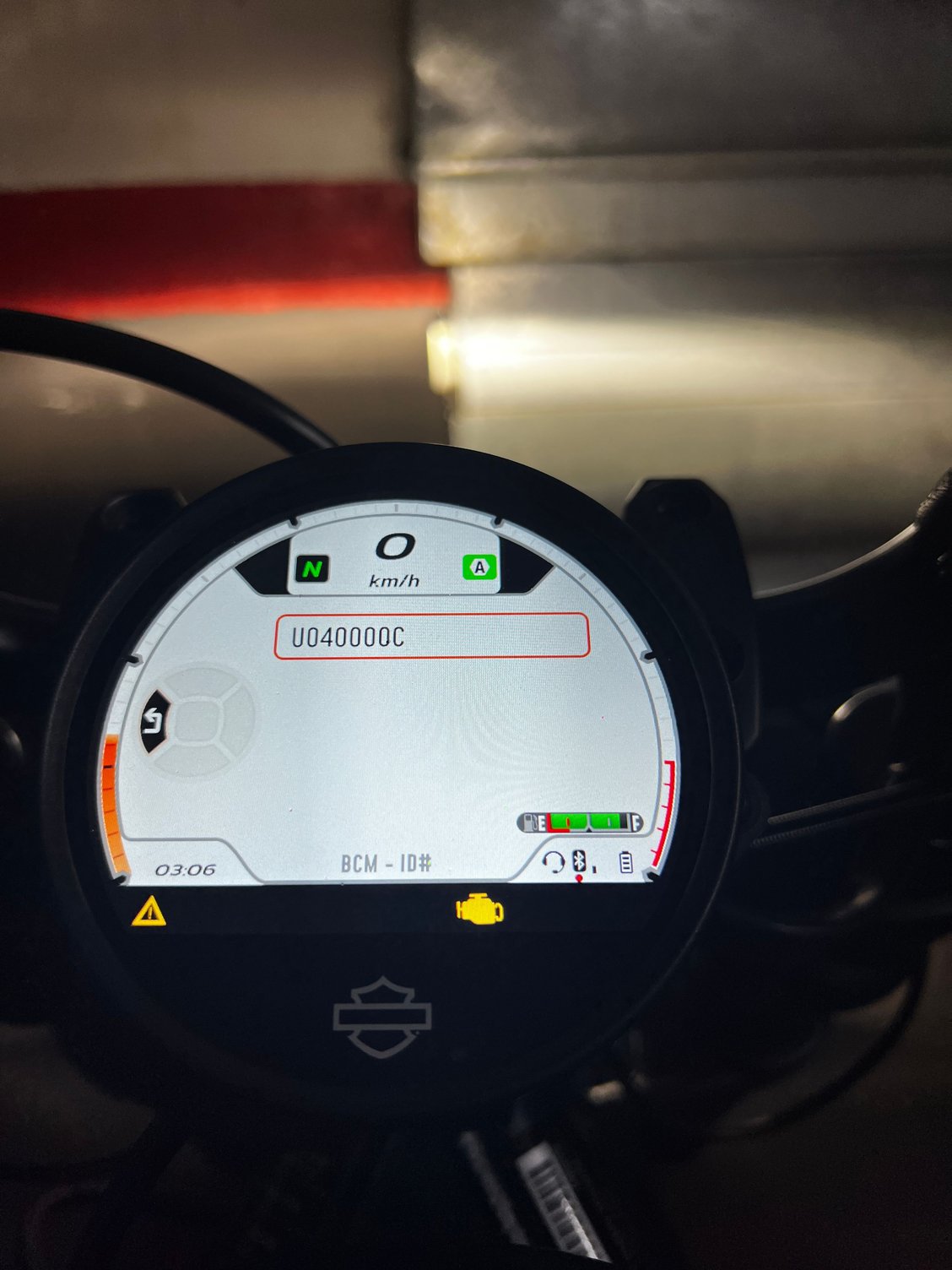

today I updated my bike to 512.513552_20220516 used USB
and have errors....
now "check engine" ON and error
U040000C come
i find same problem on Pan America
https://www.hdforums.com/forum/pan-america/1406984-new-code-popped-up.html
maybe someone has an update file for the version 5.1288.2 20211217 ?????

I think you need to take the bike to the dealer so that they update the rest of the modules.
but I thought I would ride on July 4th, and now my check engine is ON. That's why I wanted to roll back to the old version

Originally Posted by Manuelhernand
does not allow to erase the codes!
I also noticed that it does not allow erasing codes.

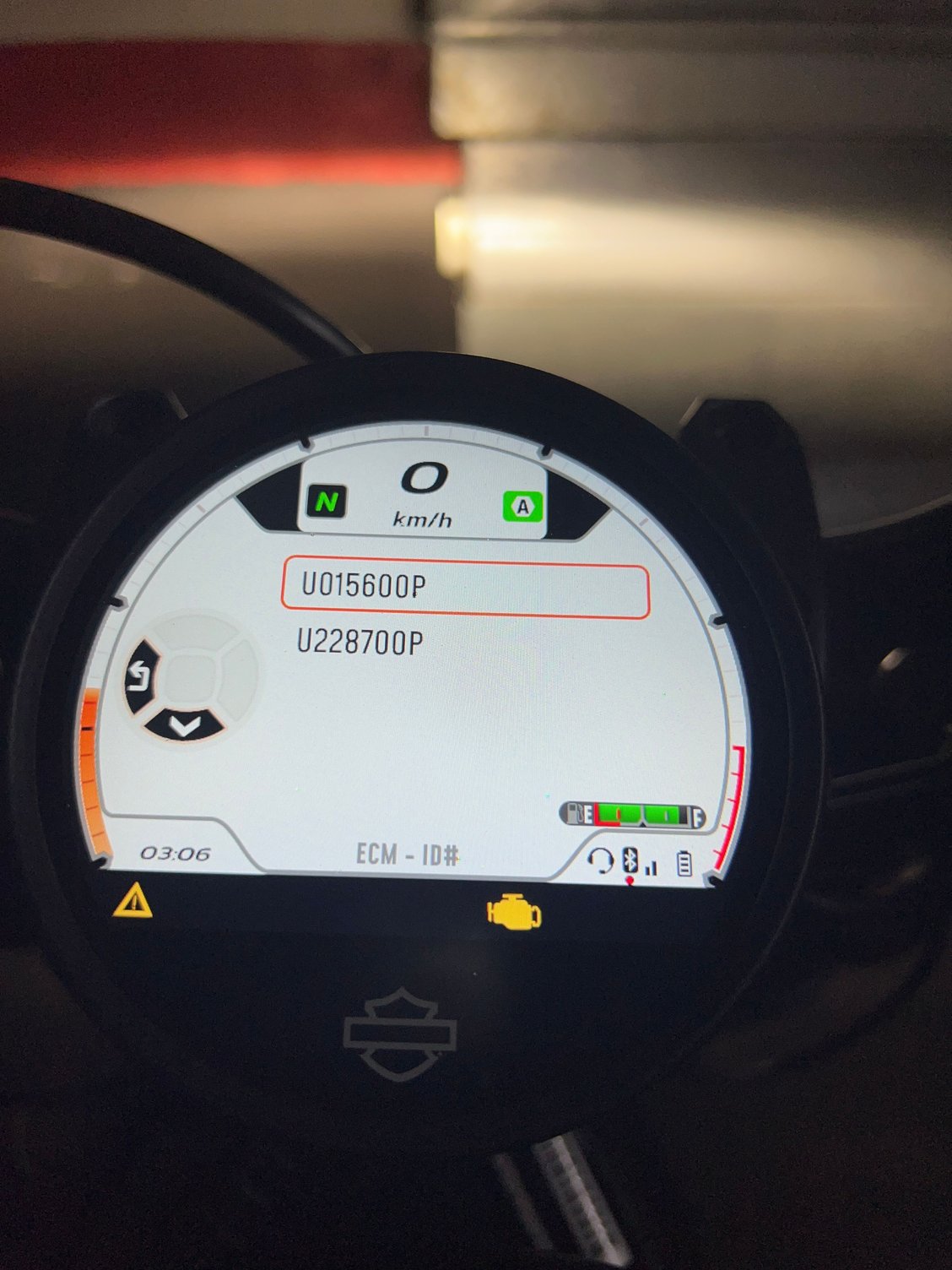

the rest of the codes disappeared by themselves except U040000C

I had to take the motorcycle to the workshop and what they have done is return it to the previous version to solve the problem, if someone manages to get version 5.13552.20220516 please share it
