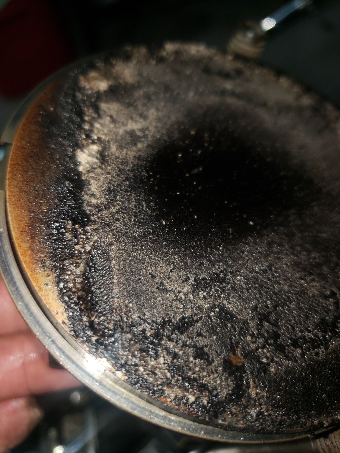

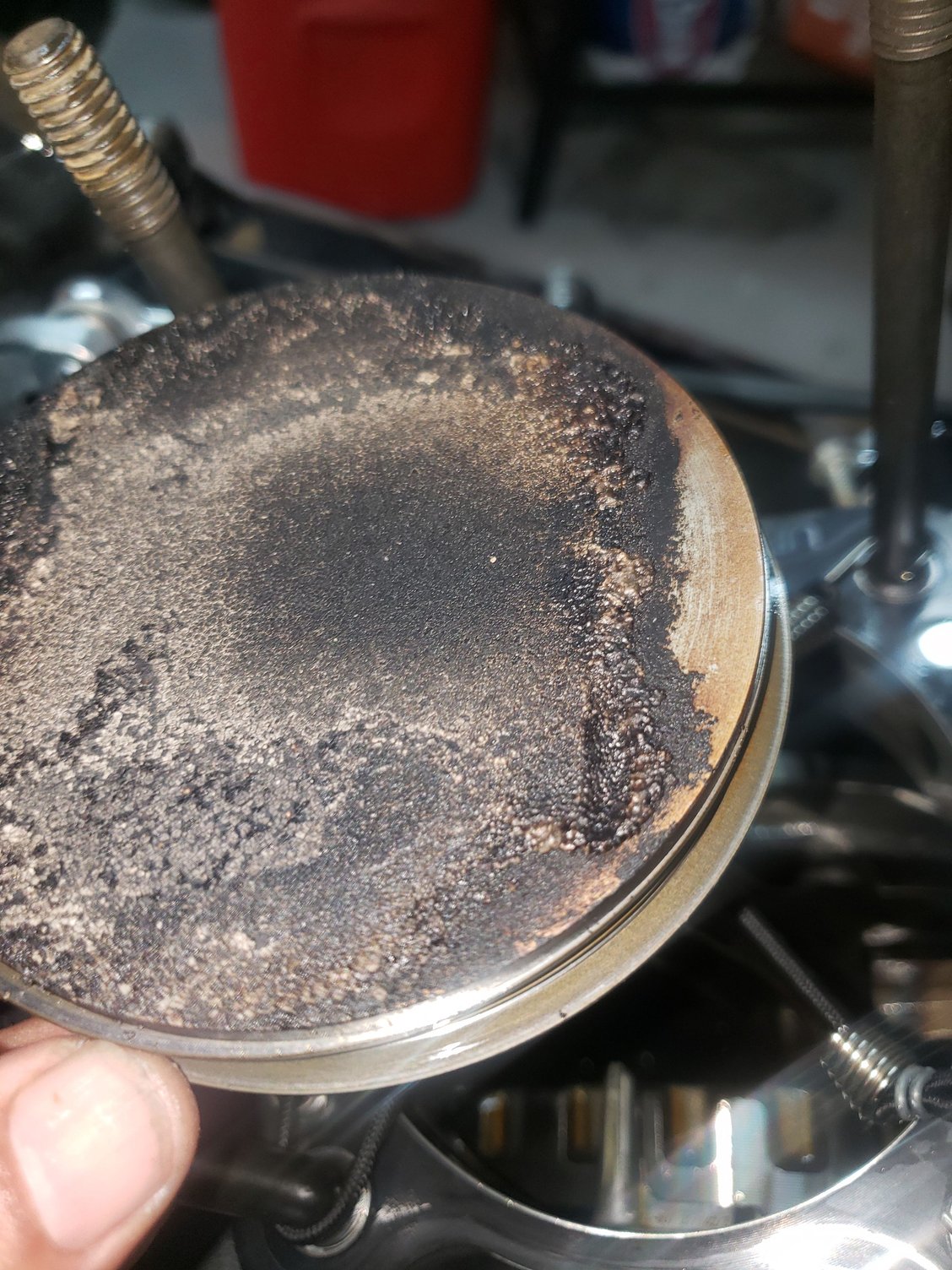

Got started on the build this morning..
got everything tore down and cleaned up,
Crank runout is at .004". good to go there.
was alot of oil deposits on the pistons. So far only 11000 miles.
