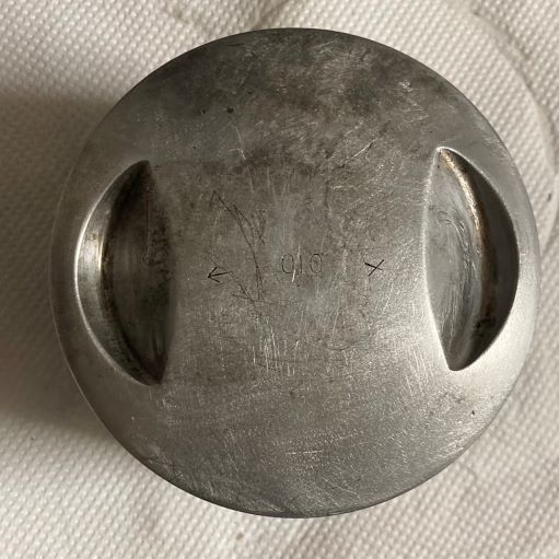

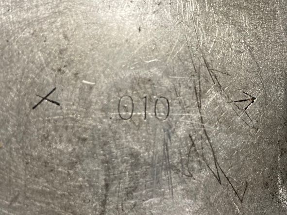

I know, so much has already been said and written, but I didn't find "my" right answer.
On the head of my pistons is an arrow opposed to an X. see photo
I've read that the HD pistons in the shovelheads have the arrow pointing in the direction of travel, forward
Aftermarkets the arrows both go towards the exhausts. So in the first cylinder it remains in the same position, forward, and in the rear cylinder it turns towards the exhaust
It's correct?
Help me.

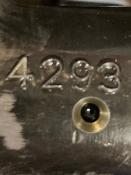

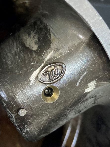

I found this logo W, inside the piston with code 4293.
It's a WISECO? see photo
Thanks to anyone who can help me

On the domed pistons for Shovelhead engines, you should notice that one valve relief in the top of the piston is larger than the other. The larger relief goes with the larger intake valve.

https://powersports.wiseco.com/media...ShovelHead.pdf

but my problem and that I'm not sure are Wiseco
Paul
two completely identical faces

The Wiseco 4293 is a shovelhead series piston. Why don’t you think that’s what you have?
I didn't know it was stock on shovelhead.
I thought the previous owner had changed them given the +0.010.....

Now I just need to figure out the "arrow" and the "X" as the faces on the piston are identical
