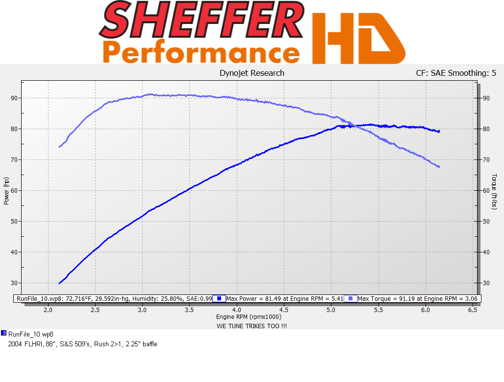

TC88 Stage 1 S&S 509 chart vis TC95 Stage 1 Andrews 48 chart. The 48 makes about 10 more TQ/HP but with 7 more cubic inches so some of the increase in performance is due to the increase in displacment; how much; dunno. The comparo makes the 509 and the 26 in the TC88 look pretty good IMHO
As has been pointed out, beehive springs will accommodate up to .600" lift, so a set of 1.7 ratio rockers on the intake side would be a cheap way to take advantage of the beehive lift and maybe pick up some TQ but definitely pick up a few ponies.
