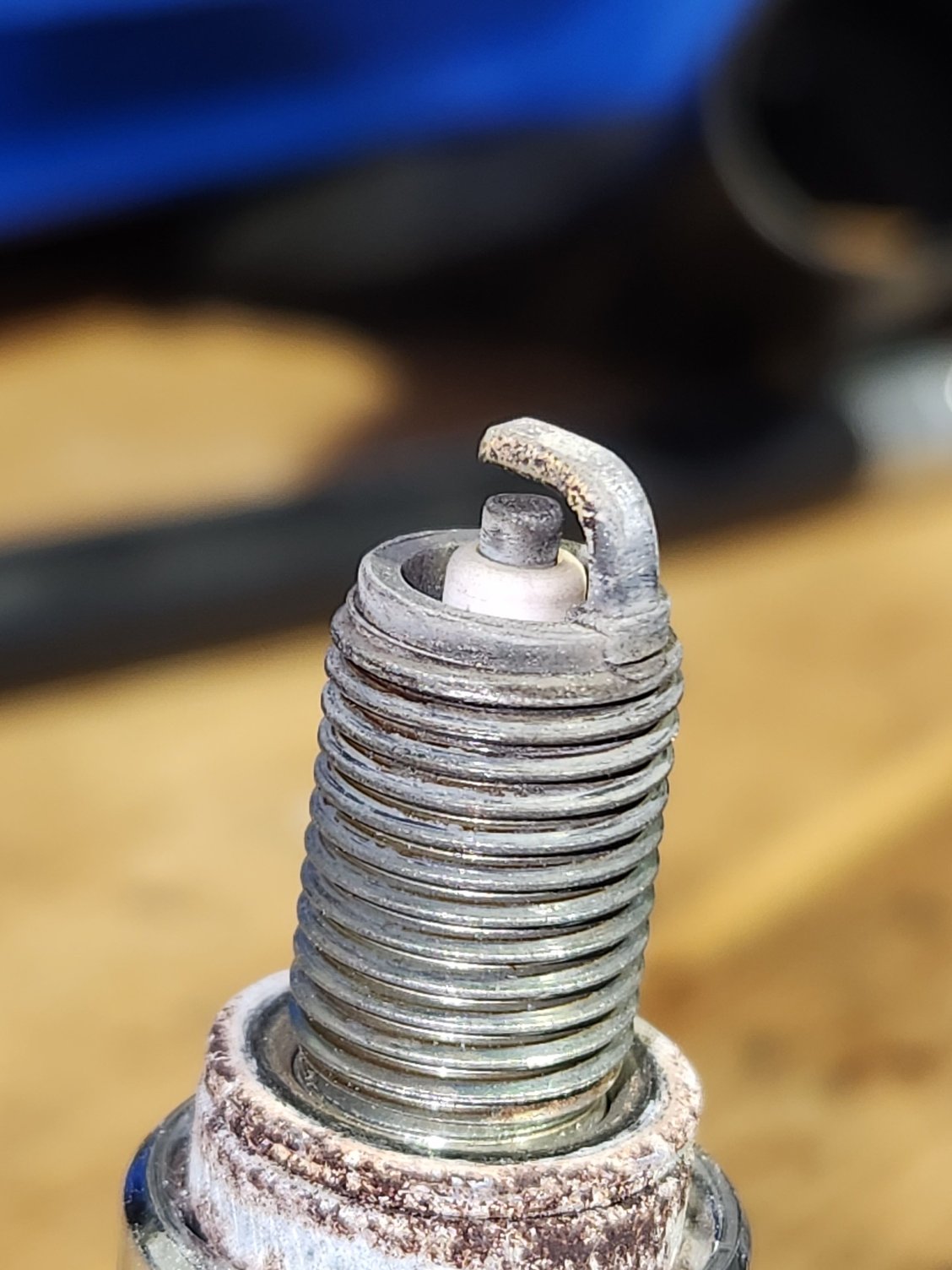

I would think 195 ccp is awesome.. What I would look closely at it's the burn on the plugs and any excess breather blow by..
Rear and front

Throw in a new set of plugs and ride it for 100 miles and report back.. The front looks a little lean.. Is the bike Carbed or injected...? Check intake seals..
Injected, will do!!

Do you have a tuner for it.. If so I would richen up the front a little.. But you still definitely need to check intake seals..
