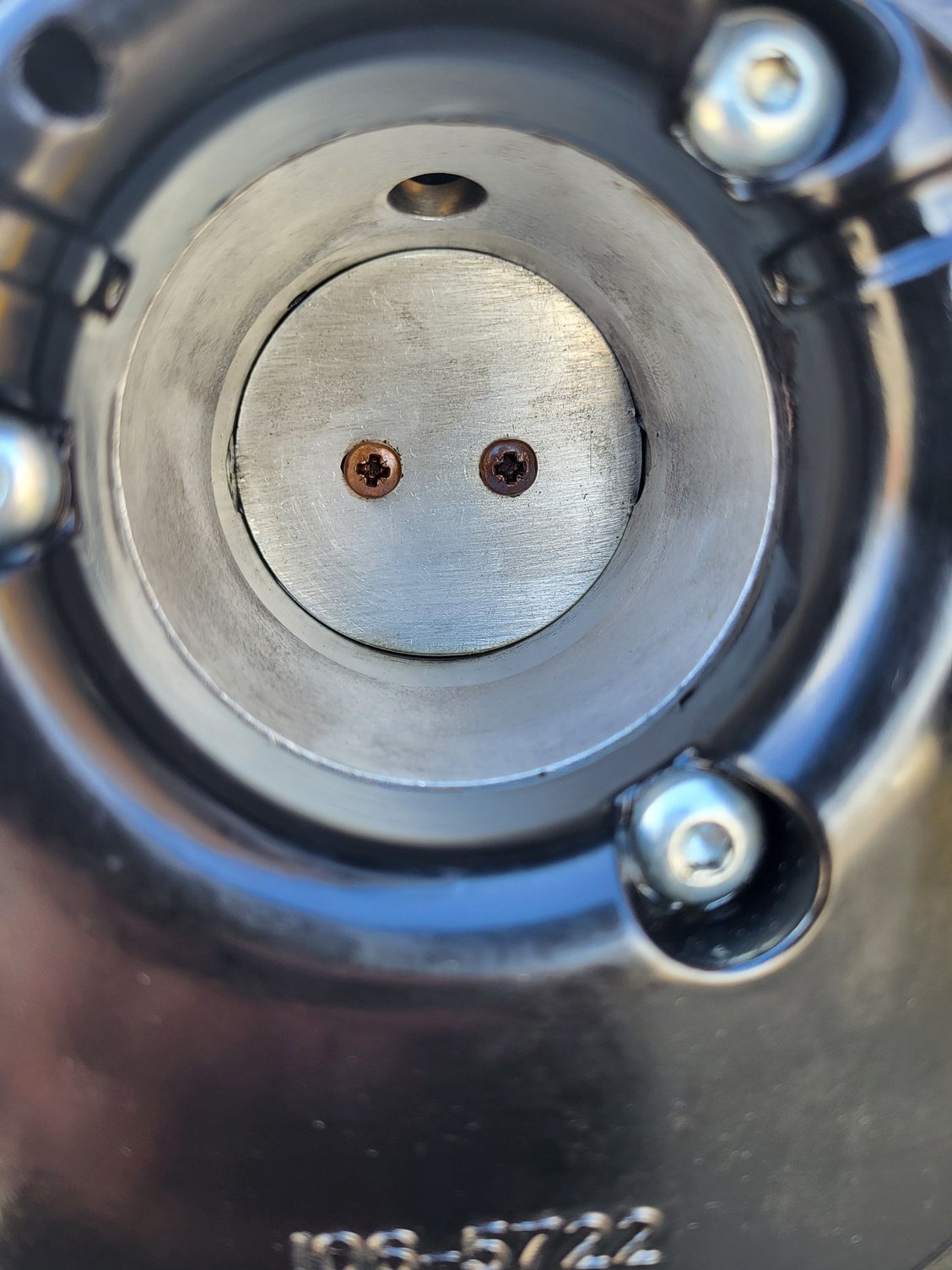

I've cleaned everything, Reinstalled IAC, messed with the stop screw, checked for leaks again. No change. Hooked it up to computer throttle position and IAC position are correct 🤷‍♂️.

Yeah, that's not a good fit and most definitely your problem.. Never seen a throttle plate go side to side.. Who machined it?

Yeah I'm thinking either that or a hairline Crack in the TB I can't see. I'd rather not put the guy on blast will PM you if you'd like. Anyone know any companies that bore 46mm to 50mm? Hillside still do it? Found Baisley performance online. Going to call them tomorrow.

What does correct mean? If idle is high and with the way your throttle blade fits. I would assume the IAC would want to be closed. This is not correct when the ecm is in idle mode. The IAC needs to open some during idle. This way it has control over idle air. Is the IAC closing all the way and then parking in an open position with a key on cycle? You should be able to visually see this.

If you take a look at the video that he put online that shows when he's operating the throttle, you can see the throttle plate moving left and right.. There's way too much gap in there.. The motor is sucking are past the massive gaps..
I think the OP should send the throttle body out and see if somebody can make a new throttle plate for it..
