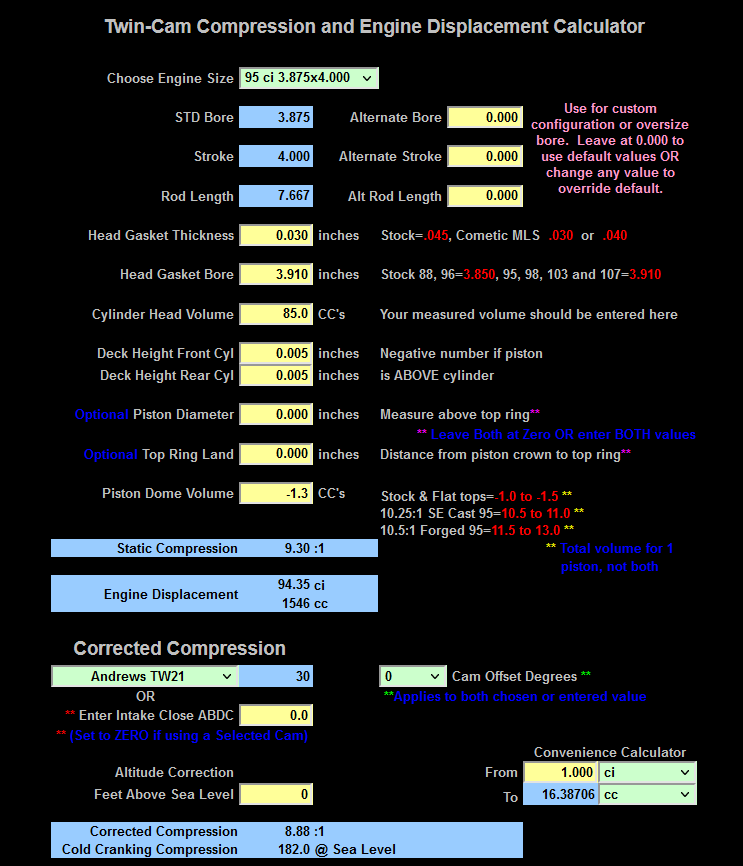

I'm building a 95" project (ex 2000 88"), Andrews 21 camshafts, JE 324712 pistons (9.25 static c.r.), 0.005 deck height, 0.030 Cometic gasket.
The calc says I'll get a ccr of 8.88.
But I'd like a 9. Can I mill the heads?
If the pistons were flattops it would be clear, but these pistons have a shallow dome.
What measurements do I need to take to figure out how much I can mill to keep the piston from hitting the head?
Or is this a bad idea and best to leave it as is?

I would measure the piston to valve clearance

Several ways to get there.
1. Reduce chamber volume to 83cc; a .015" cut should do that. This would require that the cylinder chamber volumes be measured for a starting volume. As has been advised, always a good idea to measure piston to valve clearance but, in this case, that shouldn't be an issue.
2. Advance the cam 4*.
3. Replace the Andrews 21 cam with the S&S 509; which, IMHO is a better choice.
Thanks. Piston to valve is a must.

Ironically, I have S&S 509's sitting on my shelf I was thinking they would give high cold cranking compression. But the calculator says 189. As I remember, up to 190 cold cranking compression is quite acceptable. Am I right?

Thanks a lot. Ironically, I have S&S 509's sitting on my shelf I was thinking they would give high cold cranking compression. But the calculator says 189. As I remember, up to 190 cold cranking compression is quite acceptable. Am I right?
Yes; 190psi is fine.
190psi, for me, is on the cusp of needing compression releases but many run that CCP without them. These days, some are running CCP at 200+ with no issues; I run a 98" motor at 212psi with no issues; just requires a very good tune. You can get by without CRs but if you have the heads off, investing in a set of manual compression releases would be worth it and will extend battery and starter life. They are not that expensive and the machine work for them is also not that expensive; IIRC, $125 would probably cover it.
I think you will like the 590s. I hope the bike is carbureted and not the troublesome MM EFI. Good luck with the project.

Yes the bike is on a S&S Super E carb with Dynatek ignition module.
