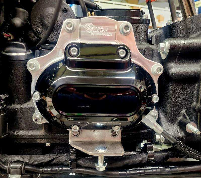

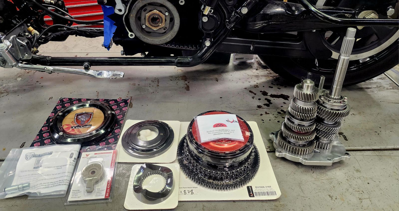

Trans is back waiting on few more parts to come in. Making head way. Billet trap kinda gives the bike away. But looks bad ***

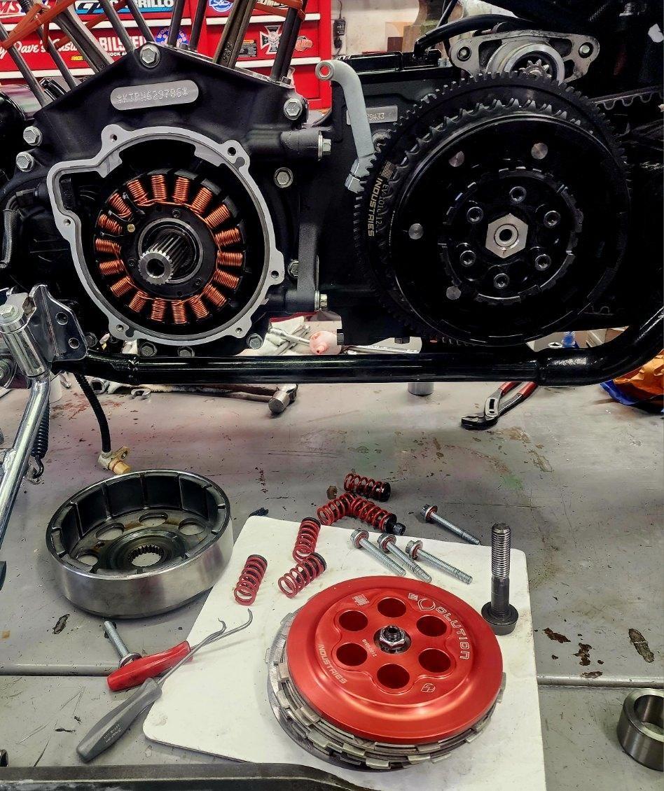

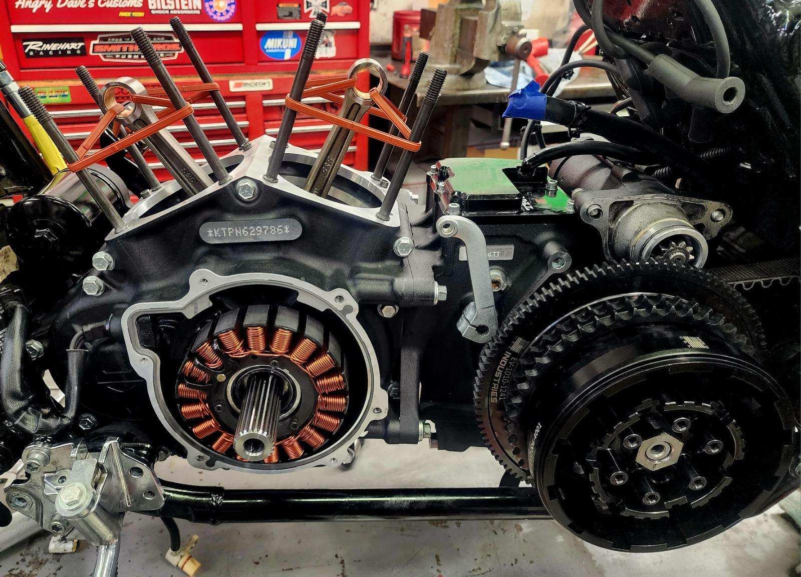

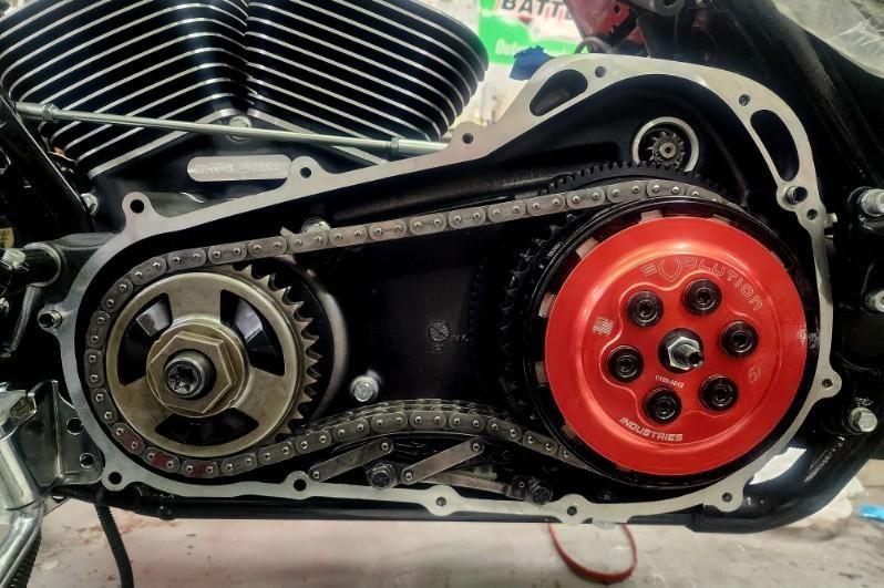

Update not a lot to add still waiting on parts.
here is what’s in so far.

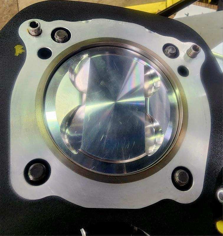

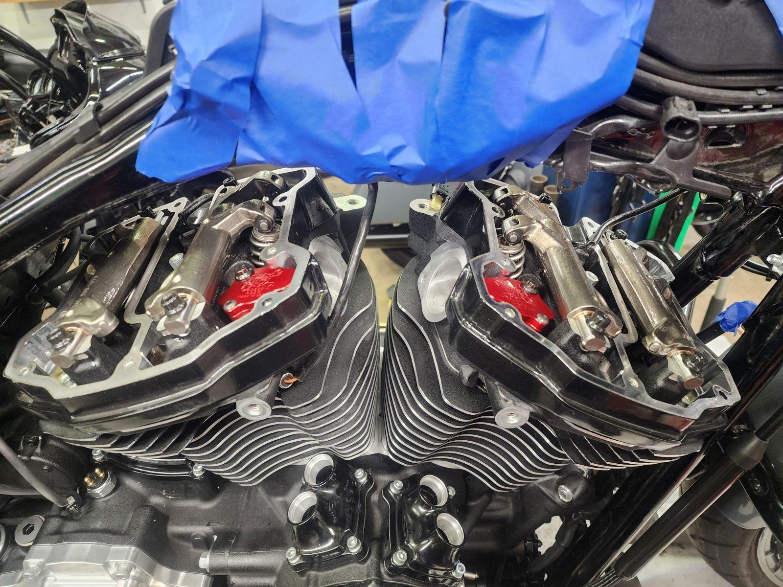

Starting to go back together. Shouldn’t be to long now. Then the bike will go to Dave Dupor DD custom cycles.

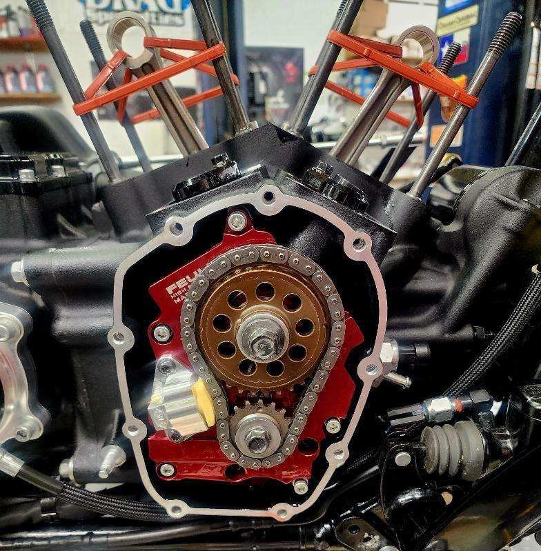

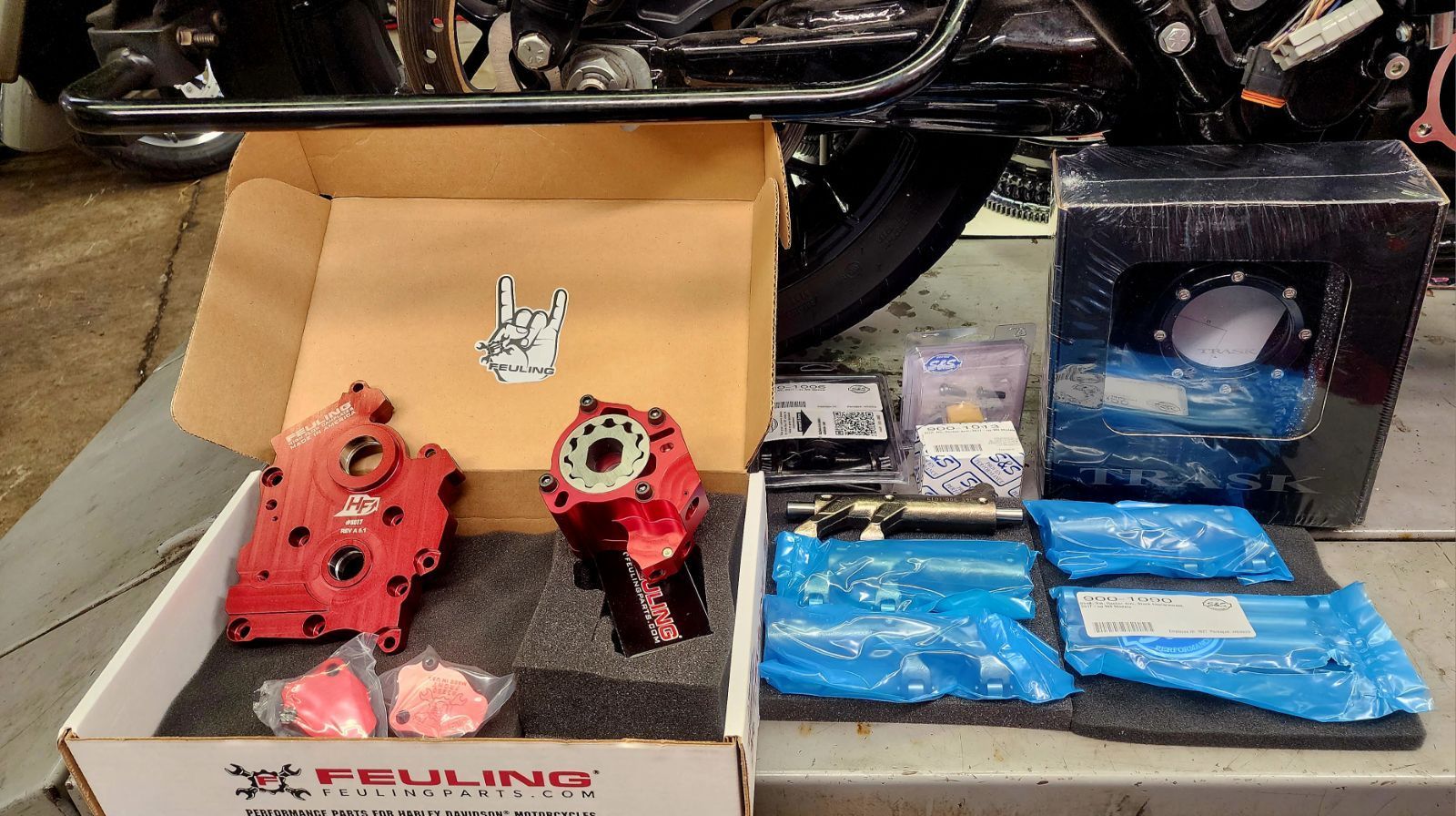

Curious, does the cam plate have a Bronze bushing insert for the pinion shaft or is it like the MOCO design, machined aluminum?

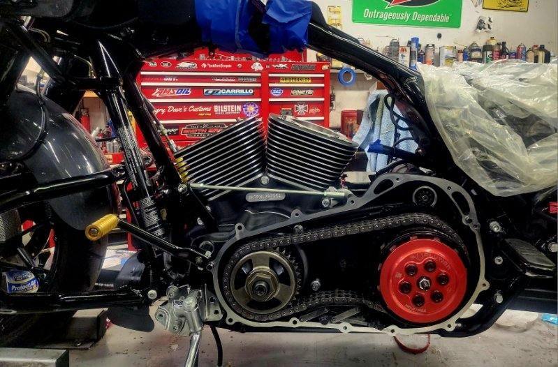

Quick update bike is mostly back together. Still waiting on exhaust and the cruisetecs to get in.
