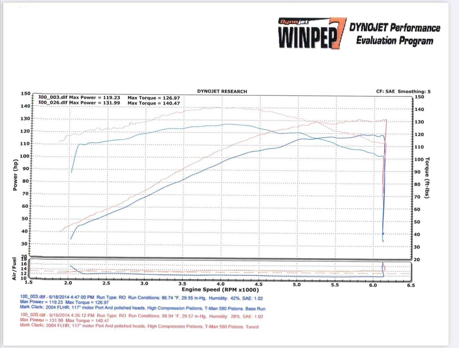

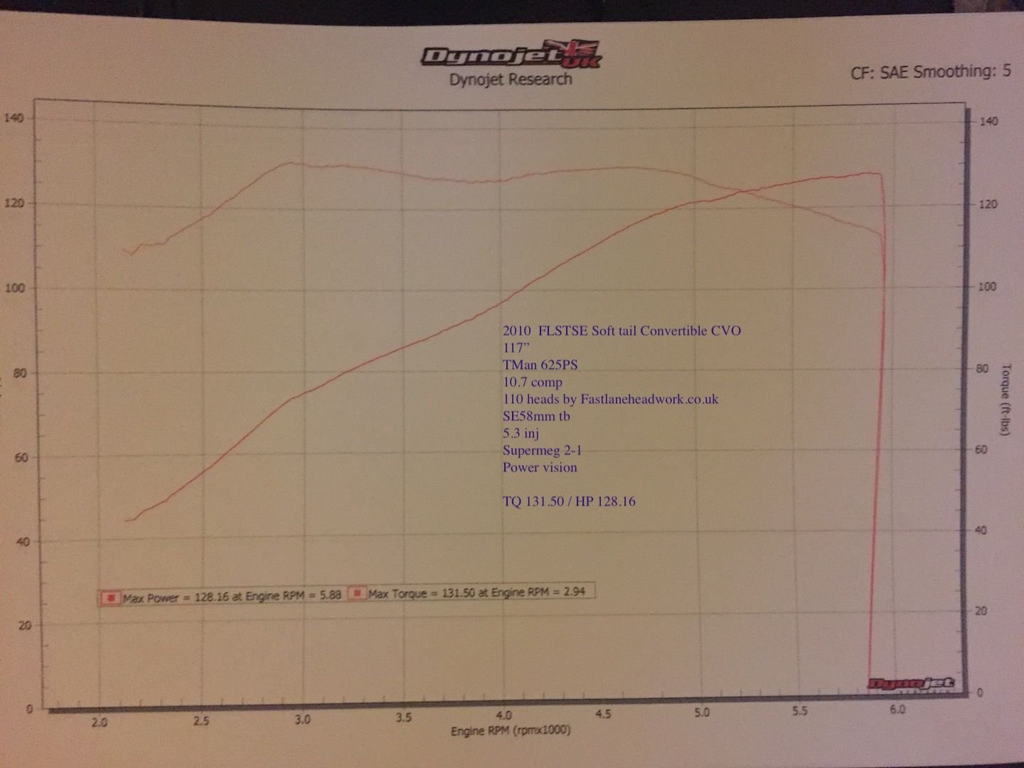

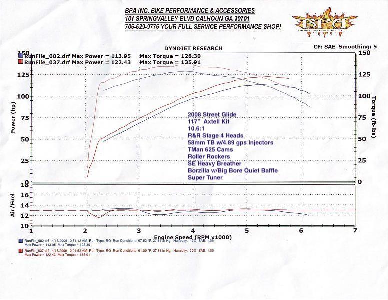

I agree with possibly tune and definitely more than an exhaust.
Here are several 117" builds with TMan 625 cam possibly to get idea of what an average 117" should produce.
Here is my 117" (2002 Road King)

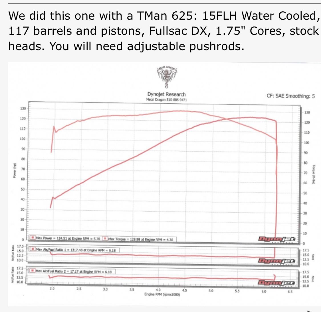

Here are a couple of 117" TMan 590 cam builds to see what potential of yours could achieve.
