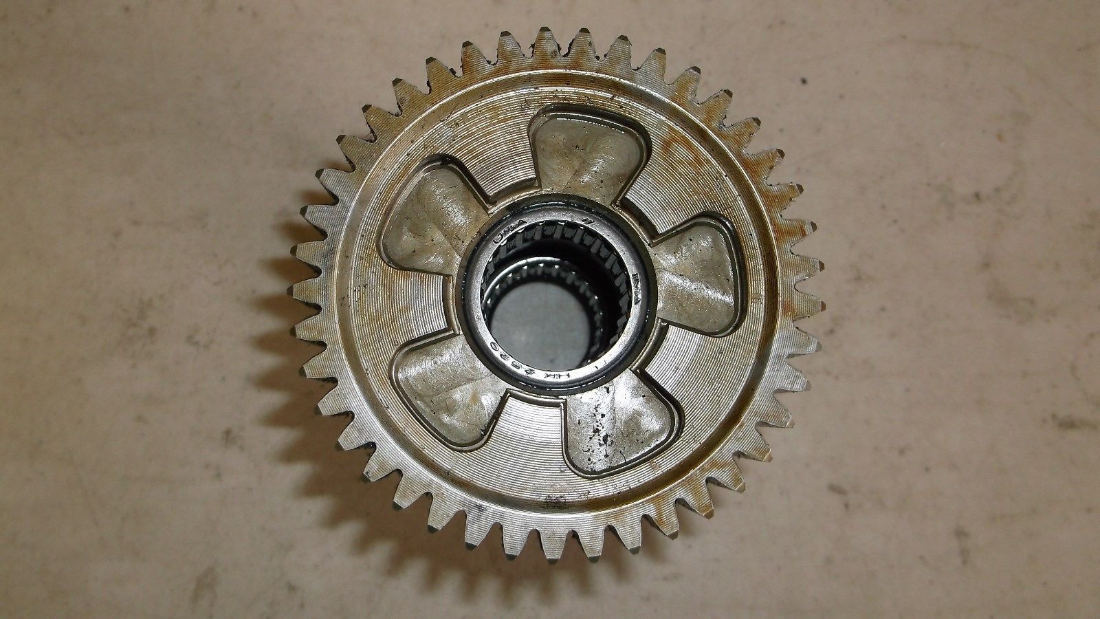

If your shifting to neutral at a light, (I do it all the time) when you pop it back in gear, Harleys sometimes don't totally engage the locking dogs that engage the drive range.
That can definitely make a clunk as the slight bevel on the dogs pulls them all the way in. And acceleration loads them. There a lot of back and forth movement in them.
Remember, all gear teeth are always engaged. The side locking lugs are what engages the gear range. If you just popped it in gear, and have clutch in, and bip the throttle, oil drag on clutch plates bangs the dogs.
Nothing unusual for mine to do it as I shift. I get a extra little clunk just as I throttle.
Be careful about reminding people the light is green. Someone behind you may be texting, think you left and help you do just that without looking up.
It's called a balk.

You get a clunk when you shift into gear. That's because all gears are spinning from oil drag between clutch plates. Without a little drag on a wet clutch non syncretized gearbox, it would not always line up to go in.
That clunk in that gear range locking in and stopping from spinning.
That second cluck is that dog play from either biping throttle or letting clutch out. Driving, I hear it mainly in second.
