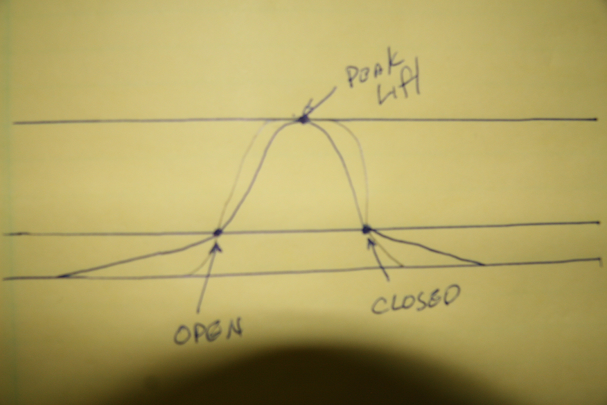

The problem with cam spec's is most of them are not correct to begin with. You have to know how the camshaft is designed and most haven't a clue. People look at intake closed from a cam card and think that tells them lots about a cam and it does not! That works about as well as pi$$ing into a 50 mph wind and hoping you do not get wet!
Take yourself a piece of paper out and draw three horizontal lines on the paper the first two about 1/4" apart and the third line about 1" above the second. This gives you the three point on a the camcard for a lobe design. Base circle is the bottom line, the second line is the 0.053" line and the third line is peak valve lift. Now the other thing that's on a cam card are what is called valve opening and closing points but neither are correct for when the valve opens or closes. What they are is a point when the lifter has moved 0.053" from the base circle. No where on a cam card does it show you how the lobe is designed, which is the most important part of it.
So now you take the middle point on the third line and place a dot in the center of the line and that's your peak valve lift point from the cam card. Now go to the left of that dot you placed on the third line and drop down to the second line and put a new dot about 1/2" to the left of the peak lift dot on the second line, That's your camcard open point. Do the same for the close point but move to the right 1/2" from the valve lift point and put the dot on the second line again. Now what you have are three points in space from your camcard. No where on a camcard does it give you any information how to start from the base circle (bottom line) to get to the second line (0,053" point) or how to get to the third line! Same goes for coming back down on the closing side points. So it is very possible for thousands upon thousands of ways to draw lines and connect the three dots! All of those designs will have the exact same spec's but will perform very very differently when installed in an engine.
Here I've drawn just two lines that meet the exact same spec's but are worlds apart in how they will perform, and as anyone can see there are plenty more lines that can be drawn through the same three points, so what does a cam card really tell you? Now the more aggressive you design on the opening side, the valve train gets nosier and it will have a short life span and on the closing side it beats the hell out of the valves and seats but is commonly done on many camshafts used in the HD world. So this is why we do not want to get into the pi$$ing match with cam card specifications. We by design, make camshafts that are made to be easy on parts and are designed for at least a 50,000 mile service life. By living with those requirements it limits some of the things we can do, but we are not after a race engine with high compression that you cannot ride across the USA two up and loaded.
If that's what your looking for we are not what you want.
Like Your read Mr. Cole.. It's kind of the difference between the say the twincam old woods W-8 and Andrews 55. Andrews has lower lift and nicer ramps but the W-8 can do much better. The W8 needs roller rockers to keep from scuffing the tops of the valves.

Kinda like the difference between a triangle and a rectangle.
