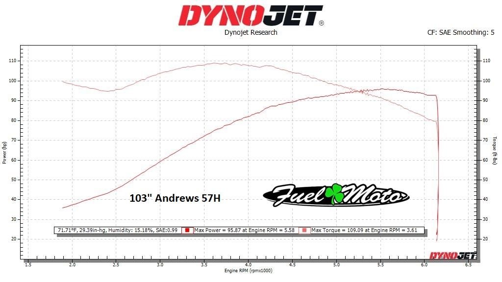

Andrews 57 is a good all around set of cams for the 103 inch motor. There are several cams that will improve the way the motor runs, just that the Andrews are not high dollar cams, so they help keep in a budget if that matters.
Below is the stock Rushmore and below that the 103 with Andrews 57's.
Not really apples to apples...Fuel Moto test was done with a 2>1, not a stock cat headpipe
Old Jun 3, 2024 | 03:41 PM
Ohio HD's Avatar
Ohio HD
Joined: Mar 2012
Posts: 1,013
Likes: 976
Who said it was apples to apples besides you?
This was just meant to give some idea as to differences in stock cam and Andrews 57.
