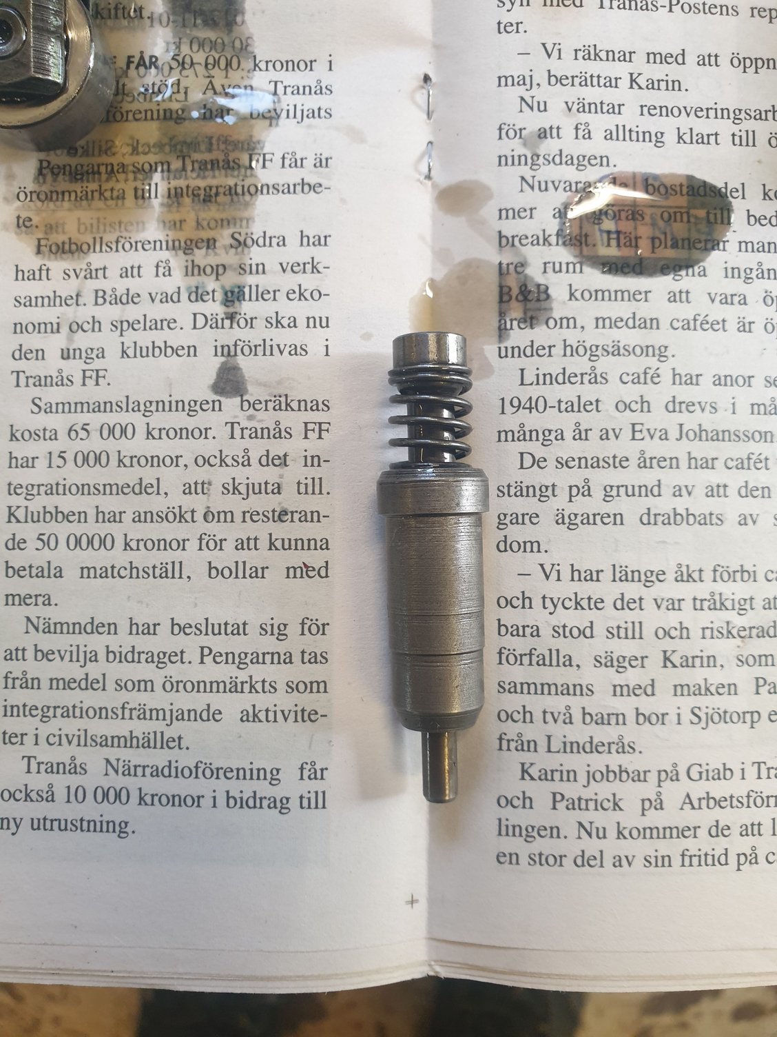

The Bike is not original. Don`t know how many Miles.
The lifter looks like this.
The small piese with the spring, can i take it appart? Thanks Goran

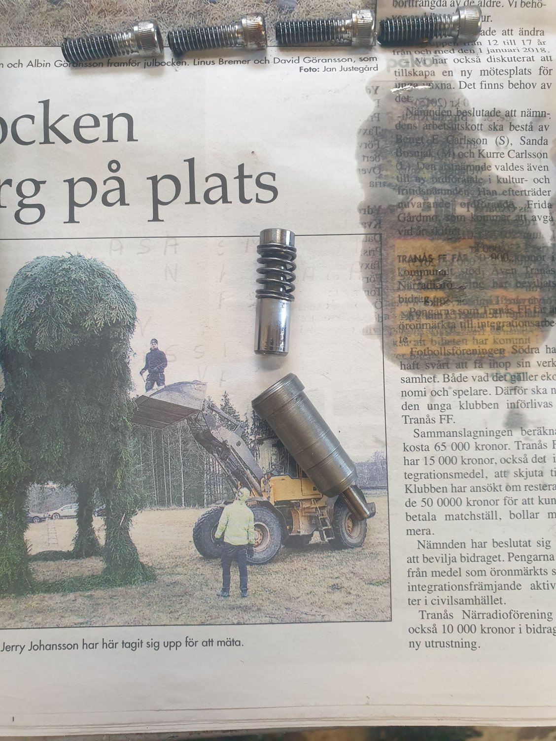

The last ring on the spring was holding it together.
I will do a good cleaning on the lifters and test drive.
Wonder where i can buy new Lifters, with good qualite and good price. Thanks Goran
