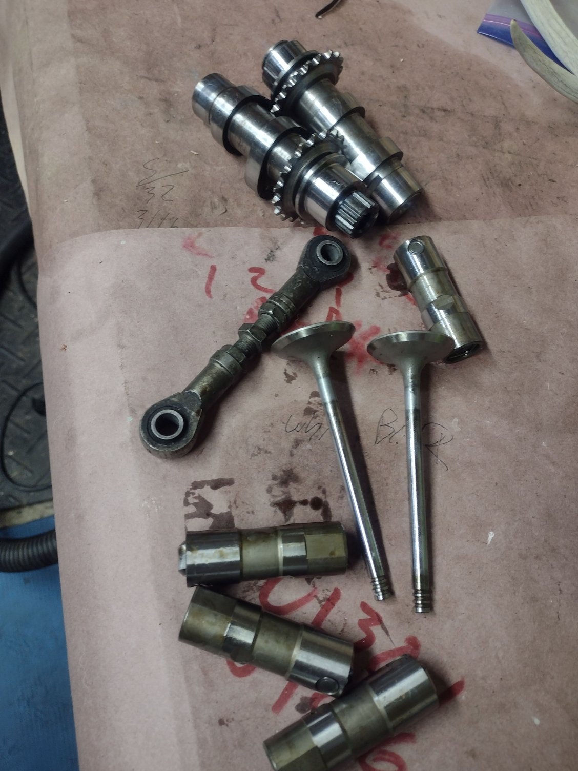

In case you were wondering what Harley lifters looked like, and because people cry out to see pics of my bikes.
While I agree you must measure wear. I am far from convinced lifters and cams are replaced as set
I have always replaced at same time, based on mileage and I was upgrading cam. Without intent to go back in cam chest

When I do cams then I always do lifters.. But depending on mileage.. As for precision by S&S they are holding up fine to spring pressures of 170/400 where the Woods Alpha lifters failed...

Thanks all for sharing your experience. I swapped my stock tappets with 30k on them for S&S Precision lifters with the Quickie installation kit (rods and tubes).
Aside from some self-imposed drama due to carelessness, the job was easy.
The lifters I took out were still good- so sign of impending doom. But I can say that the new ones are noticeably quieter- no more tap-tap-tap.
So now I have piece of mind- worth its weight in gold.
